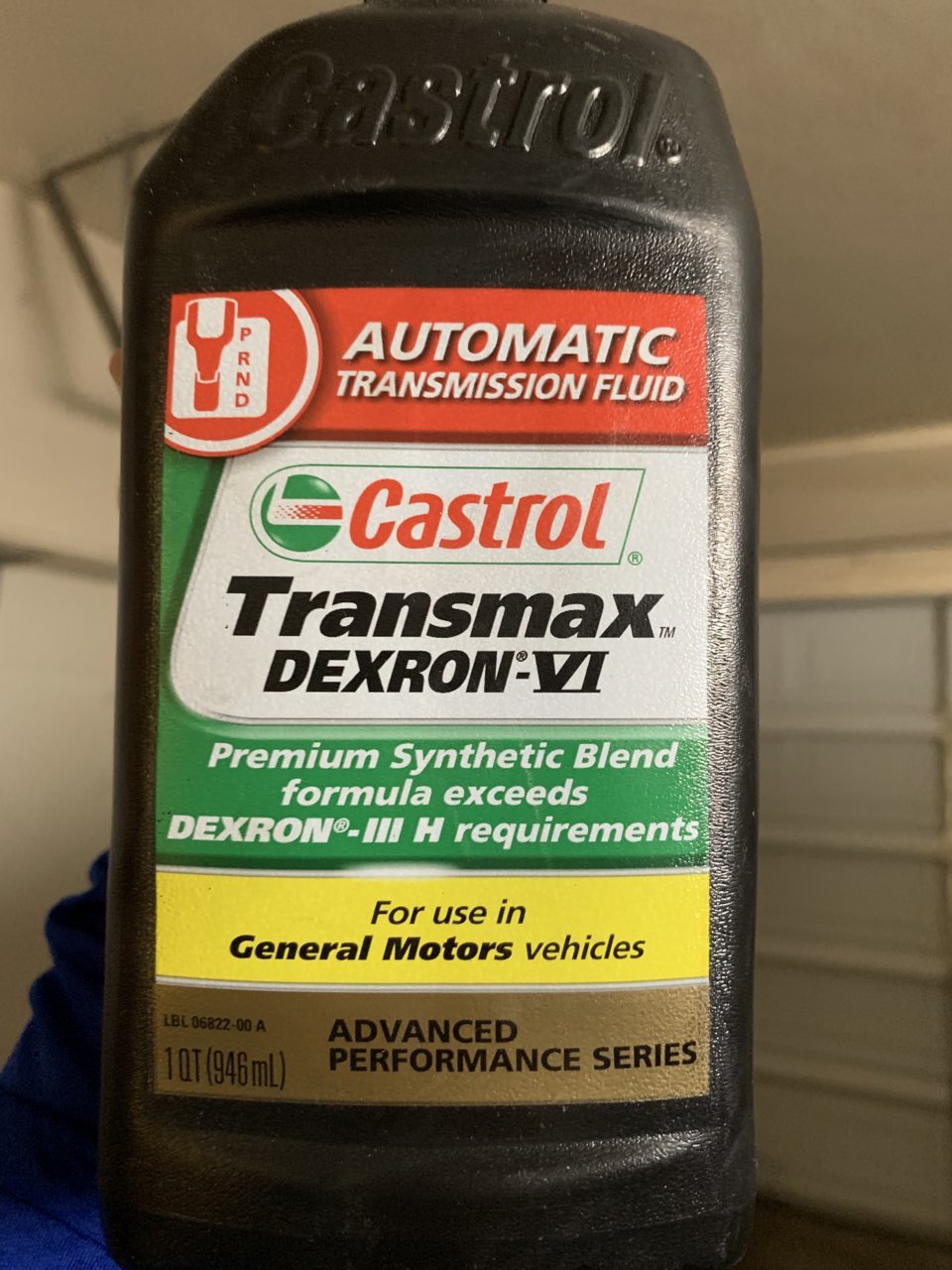

    Dumb question, are you filling with ATF or power steering fluid?

    I’m using dex/merc or dexronVI. One of the ones that says it’s good for DexronIII that the manufacturer calls for. Lemme take a pic

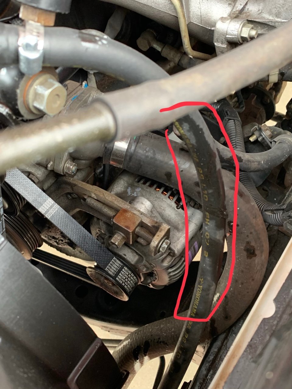

    Update:
    Rebuilt the oem power steering pump and go my money back from the new one I purchased (same whine, but power steering works great)
    Went to put in a magnetic inline filter today and saw this (pic below probably). Return line was wet with goopy drippings on the radiator hose and alternator. Took two-three weeks for that amount of leakage to be found. Cleaned off the hose and drove around for half an hour. Came home and found two new drip's on the lower radiator line. Felt the hose and low and behold, very small wet spot on my finger.
    SO, I'm going to NAPA to buy a generic return line hose for $15.
    My guess is what happened was I got some cracks in the hose from clearing out my line over and over again. I would disconnect the upper portion of the hose, fold it in half with a 5 gallon bucket underneath, lift up the truck, and turn the wheel until there was no more power steering fluid leaking out...
    HOPEFULLY this works. If not, then we will know our answer that it's probably the mesh inside the reservoir. I've checked most of the metal parts of my return line and I'd say they aren't the culprit, but I'll keep my eyes open.
    Kinda tired of lifting the truck up and trying to bleed the system.
