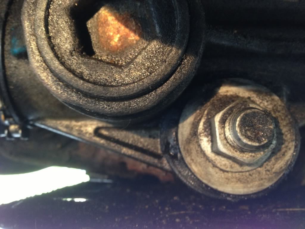

    I've been experiencing low power steering fluid levels since I got my used 2002 tacoma TRD WITH 126k on odometer. I've kept an eye on it to spot the source of the issue, and refilled when needed. I hadn't seen any seeping around the resevoir, or anywhere else until I was able to get under the truck today.
    While under there, I noticed leaking in the 2 photos below. There are 2 rubber gaskets that both seem crushed and seeping some type of fluid. Not a ton, but enough to cover the areas below them with a slick of moisture.
    C89B94C4-29F5-4021-A038-3C83C9B9C324-529_dd2c5b1db74cb00daa1989ad6ce9e8918683e439.jpg
    2BE96681-CF3E-4100-A825-AADCAADD439F-529_71d31df41aef24a4fd8d5437414a19b8375b9aa2.jpg
    I'm wondering if the leakage in these areas would cause the low fluid level in the resevoir. I have not been able to spot anything else leaking. If you could point me in the right direction to check - it's much appreciated.

    Those rack bushings are shot. That rust looks pretty bad. May need a new rack my friend.

    Thanks for the quick response. Can you tell me if this would be causing low level in the resevoir - or is this a whole seperate issue???

    Those bushings are the ps mounts. I suggest degreasing the area and power pressure washing it to clear off any fluid. Then drive it a few miles, after that you can check where the leak is coming from. Most commonly leaks occur from the fittings going in to the rack, where inner tie rods go in to the rack, around the pump or reservoir, and some times leak from broken tubing. But it does look like those bushings need to be replaced after the leak is fixed. Good luck

    Looks like your passenger side bushing is worn out, and has then in turn allowed debris between bushing and the housing of the rack, causing the metal to wear through, allowing oil to leak, which I will guarantee is why your reservoir is low!
    When you (or whoever) replaces the rack, make sure to throw a set of these in: http://www.ebay.com/itm/New-Energy-Susp-Kit-Steering-Rack-Bushing-Black-Truck-Toyota-8-10101G-/370744435805?pt=Motors_Car_Truck_Parts_Accessories&fits=Model%3ATacoma&hash=item565217245d&vxp=mtr
    They will last much longer, and tigthen up the feel of your steering.
