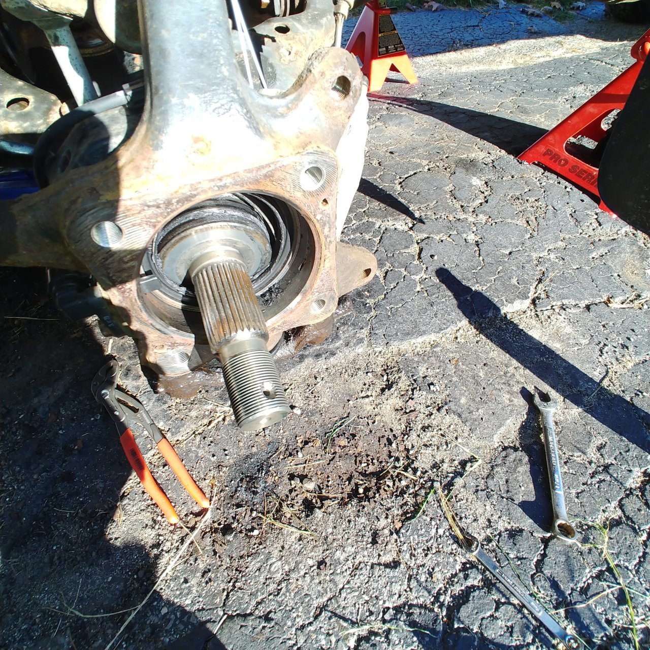

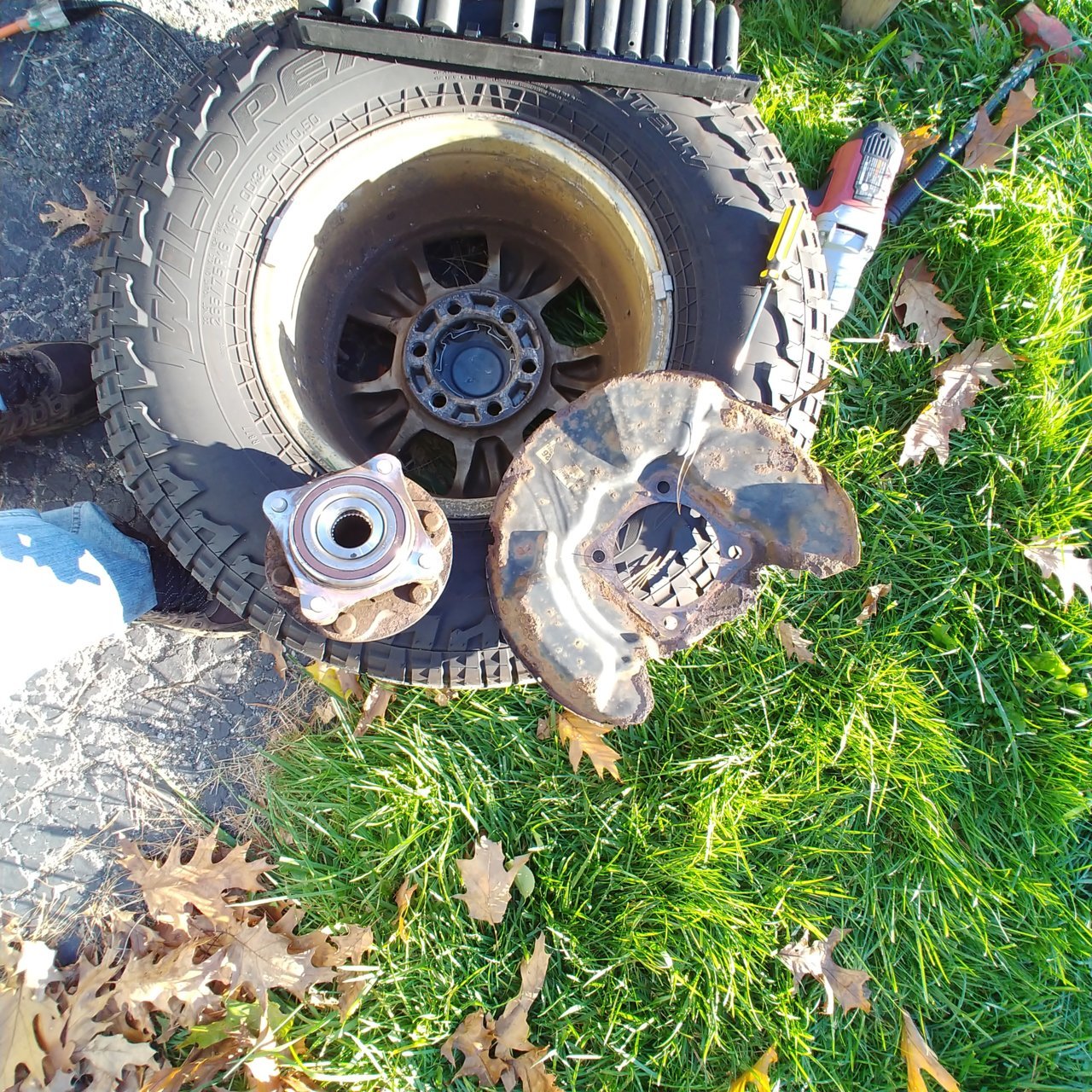

    So progress was made. Taking out the old hub was interesting. Took me about 2 hours. But it looks to me like the seal for the CV needs to be replaced.
    So I tried to follow the instructions in the video to remove the lower ball joint. Step 1 was to remove the cotter pin. It snapped right off with nothing left to grab a hold of. I spent and hour trying to get it out.
    Any advice on how to proceed. I plan to replace the rusted out cover for the brakes.

    Try loosening/tightening the castle nut and see if you can shear off the remnants of the cotter pin. Don’t go at it all in one shot to avoid damaging the threads of the ball joint. Or you might be able to get a punch in there to push it out.

    You're just try to get the spindle clear of the CV axle to replace the seals? The lower ball joint is fine? If so, don't try to separate the lower ball joint. Just undo the two bolts holding the steering stop to the spindle. Don't worry about the cotter pin - 13 years of rust will keep the nut tight even without a cotter pin.

    Ok. I tried again to get the seal out. I was able to remove the two bolts holding the lower control arm to the knuckle. I still could not get CV out of the steering knuckle. Finally gave up and was going to see what it would take to remove the whole thing. But I took one last look at the video. You can see in the video that the sway bar connection to the knuckle has been removed. So they skipped that step.
    Anything I should know before I disconnect the sway bar? The truck is on 2 jack stands, but the passenger side tire is touching the ground right now.

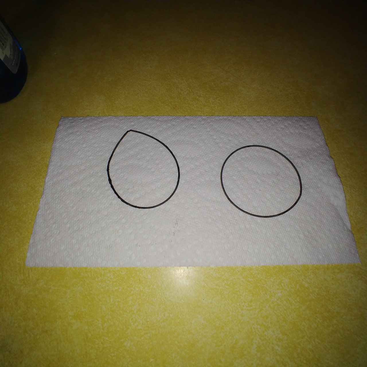

    Also, I discovered to spring things wrapped around the CV. I thought it was part of the failed seal. But it's not rubber but tightly wrapped springs. I did manage to remove them. What are they? Do I replace them?

    Never mind on the spring things. They are part of the seal, and the new seal has them.

    OK. So I had a few more hours to work on it today.
    Once I got the sway bar disconnected from the steering knuckle, I could get the CV free of the knuckle. The seal popped right out. From there I clean everything with paper towels, put the new seal on the CV, and started re-assembling stuff. It went pretty good until the sun started setting. I was trying to torque the big spindle nut at the time. The brakes are not back on it yet.
