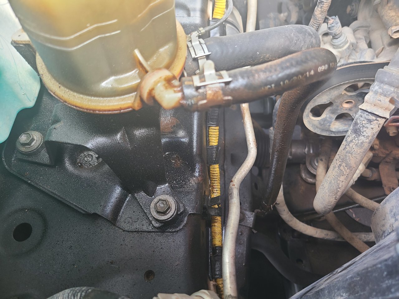

    Hey guys, I'm new here and am looking for some advice to fix a leak on my truck.
    I have been tinkering on my taco and noticed by my power steering reservoir there was some oil and gunk around there and on the hose. I'm no mechanic by any means, so I'm not familiar with power steering systems so not sure what this hose is, and if I can replace it without draining the resivoir. I appreciate your guys' time. [​IMG] https://www.tacomaworld.com/media/albums/leaking-power-steering-hose.71479/

    That be the PS reservoir outlet hose. However, the leak could also be a cracked reservoir. You’ll have to remove both to inspect them. But no, you cant replace either hose without draining the reservoir. A trick is to use a turkey baster to remove the PS from the reservoir to minimize spillage. Use ATF hose to replace the outlet hose. You may want to first power wash the area to wash off that mess.

    Hard to tell from the angle but it looks overfilled. It could be pushing it out the cap. Have you added fluid? It must be checked while the engine is running.

    Like @Chuy mentioned it could be either the return hose (the upper one coated in oil) or the reservoir as the root culprit. Generally for leaks I like to start from ground zero by cleaning everything up first, then observing the suspected area over time to possibly narrow down where exactly the leak is originating from.

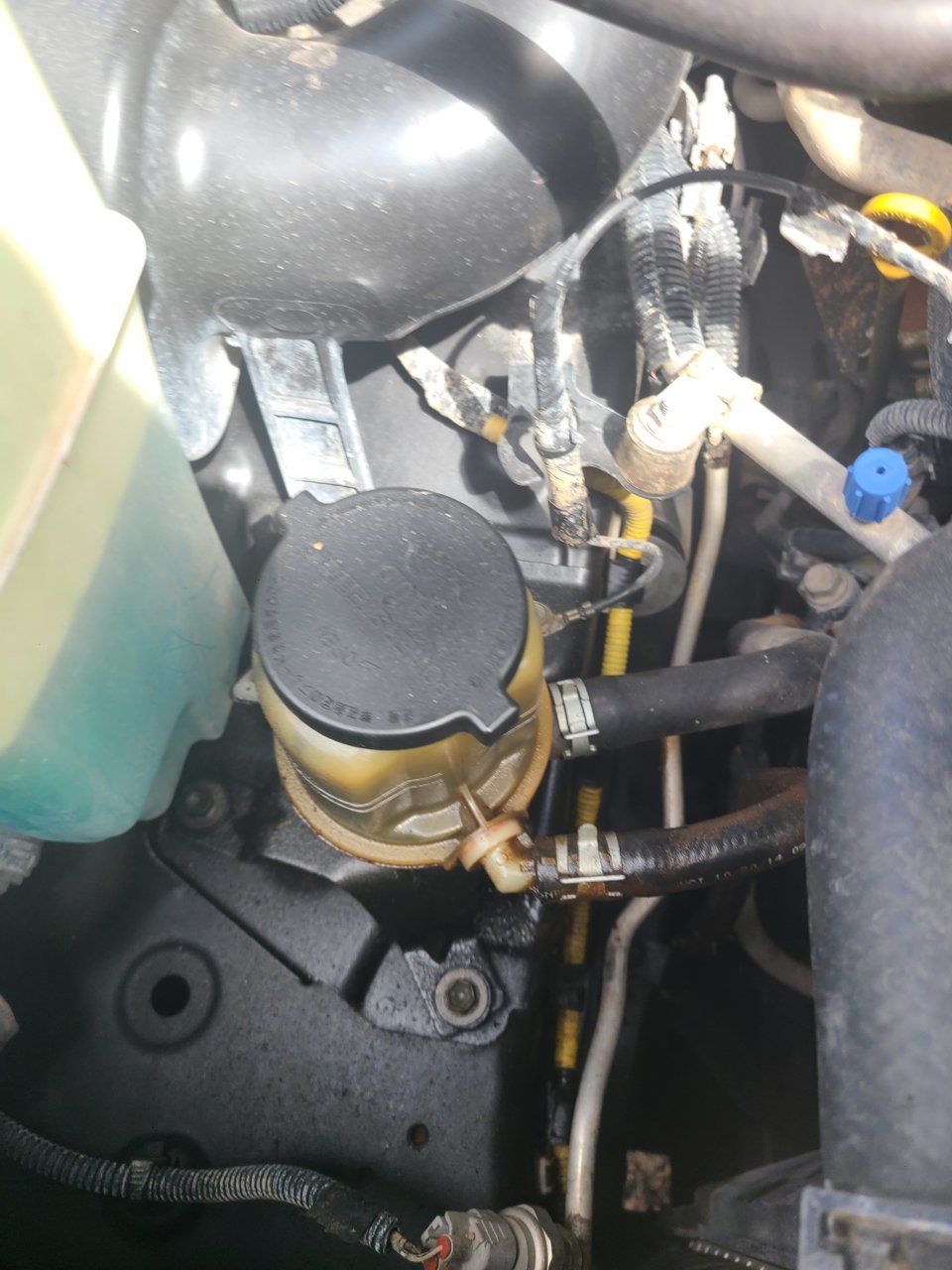

    Good idea. I ran the truck and checked the fluid level and it was plum full. Wondering if maybe it did just overflow from the top. I'm gonna clean it all up and monitor it and see if it comes back

    Interesting. In the first pic it does look like the fluid level is well above the indicator lines, but then in that second pic it looks like it's sitting between them.

    It's leaking at the hose, the rubber gets hard and flat under the clamp. You might try moving the clamp to a different position but if the whole hose is hard just replace it

    Also my advice: Buy a new Doorman reservoir and replace the return line with 5/8" transmission hose. Use new constant-tension clamps on both ends of the hose. This is what I did to make my reservoir finally stop leaking and looking like yours. I never found the actual leak, just replaced things until it finally stopped.
