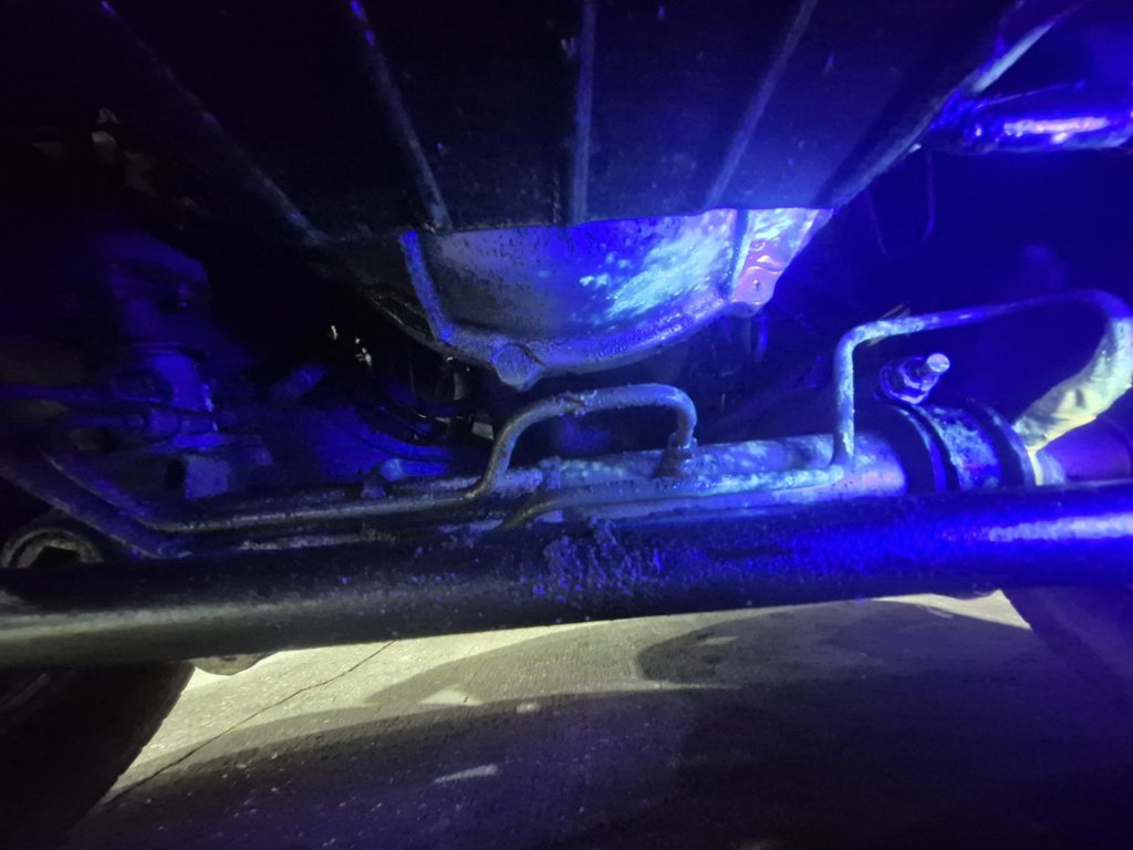

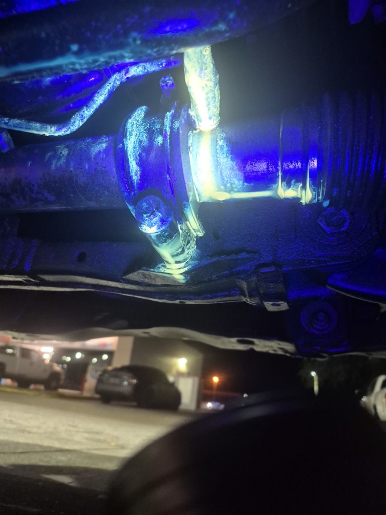

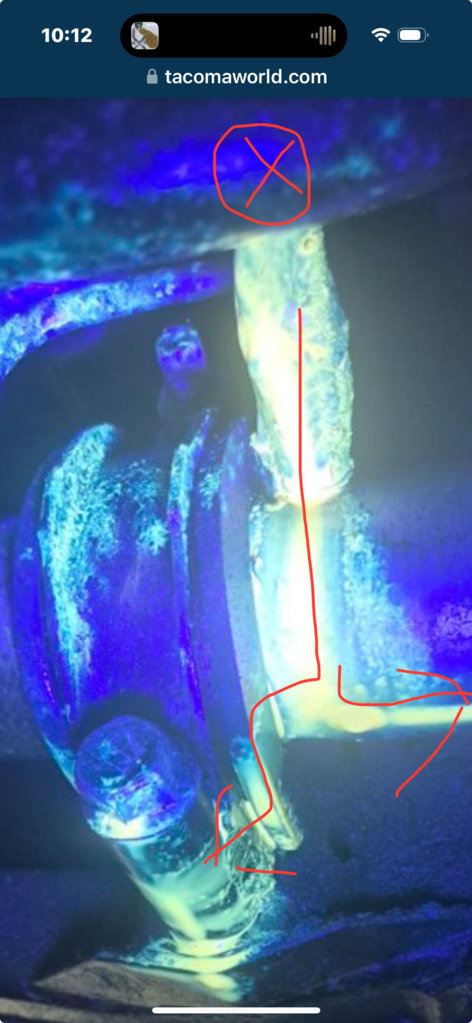

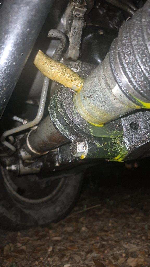

    Just wanna know if this needs a line or a rack replacement, I've never had this issue before. Bad powersteering leak

    Really good documentary pix!
    Thinking that line that has masking tape (???) around it.

    I have no honest idea, I've felt it before and it might be some kind of weld. It's hardened and has been like that since I got it

    That’s JB weld! 95% sure!

    Any idea how to get it off? Blowtorch maybe? Replacing the line would be easy but that makes it an issue

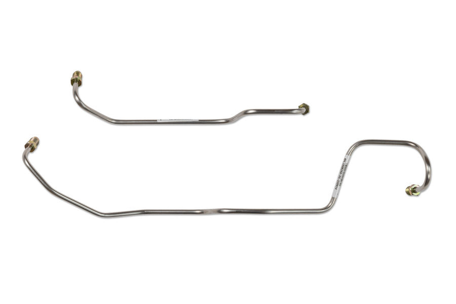

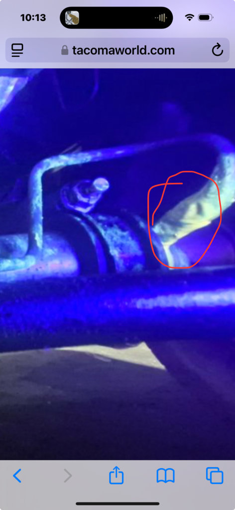

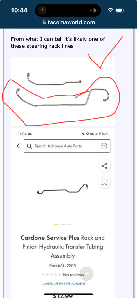

    Next step trying to find tht line
    I’m not positive but bc the location is furthest to end of rack, my guess is that is return line
    Follow hard line up to make sure
    (Or maybe another member will confirm)

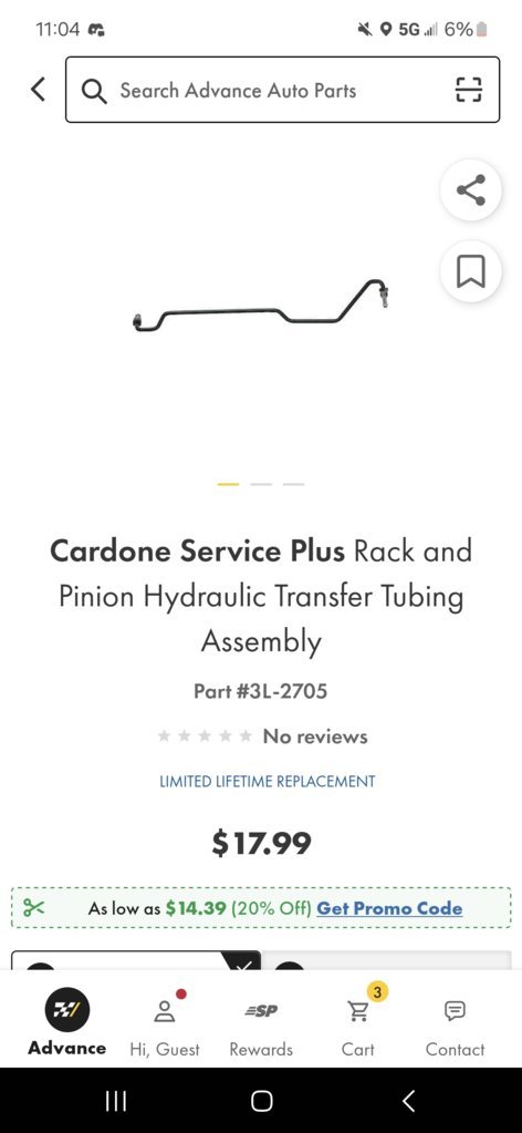

    From what I can tell it's likely one of these steering rack lines

    Firstly
    Chisel that epoxy shit fix off with flathead
    Then u will have better idea what you’re dealing with

    That one

    For a 2001 taco, if the rack has not been done yet, you might as well replace rack assembly. It's either on the way out, or it is the problem.

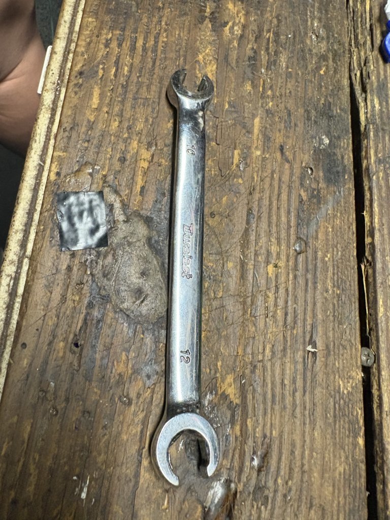

    Oh
    To take off line
    Use one of these $10
    azurehaize[OP] likes this.

    I've definitely considered it. I ran an experiment a few weeks ago where I ran trans tune through the system and it turned like butter though. At least while it still had fluid in it. Dust boots also aren't soaked, the grime is from oil filter leaks and power steering as far as I know
