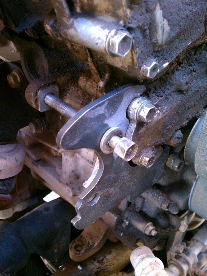

    K&N and 33's
    Jimmyh likes this.
  19. Dec 2, 2015 at 4:47 AM
    #19
    Jimmyh
    Jimmyh Well-Known Member
    May 16, 2012
    #78991
    13,782
    SC
    2012 Prerunner SR5
    That is one sweet job of making do. I feel you can do the same as I mentioned in my earlier post above. If you can't do it yourself, print the pictures above and take them to a machine shop. I'll grant you it will be cheaper than a new timing cover and installation. Probably a lot stronger too.
    billybob50 likes this.
