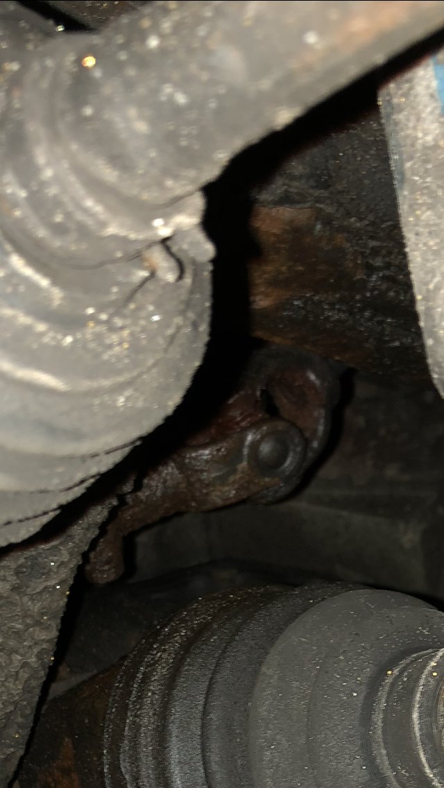

    Hi guys! My 05 taco 4x4 has an issue with the power steering and I’m wondering what it is. When I’m going slow doing something like turning into a Parking space, the truck is extremely hard to turn. Any ideas on what the issue is?

    Intermediate steering shaft.
    Been a growing topic.

    Ah got it! I’ll look Into it thanks!

    Crank your wheels left.
    Above the axle drivers side look for this.

    Sweet thanks, will do! Seems like a decently simple job

    Power steering is supposed to aid in low speed turning. So if you have problems turning... your power steering aint workin at all.
    If the above checks out Look at your fluid. If it looks burned and nasty your pump probably has gone bad.

    Yeah, better description would be low speed turning, but only at a certain point does it get stiff, not all the way
