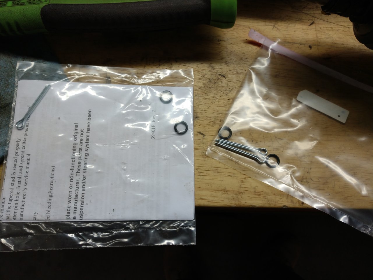

    The ones in the MasterPro kits are just black.
    Anyway thanks for letting me bounce ideas off the forum.
    And yeah, this first unit leaked severely in under 18 months - it'd lose a large sauce pan worth of fluid in a day from the right side. ...and of course the accordian boot was holding probably that much still.
    Pretty much toasted the pump (also an MP reman) but I just warrantied both. Soo...save your receipts and don't buy reman racks from O'Reilly :(

    These are the MasterPro kits, just black and a couple chintzy cotter pins for the TRE's
