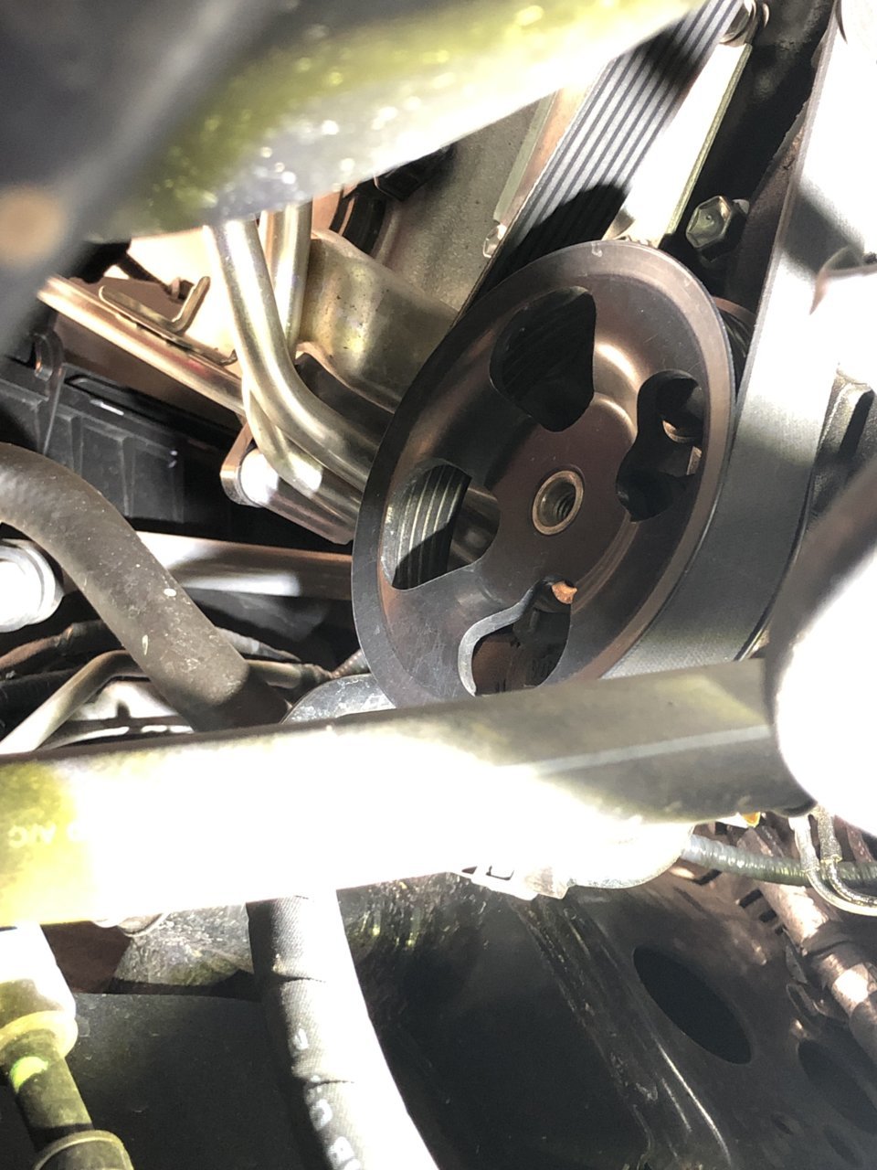

    I was changing my oil today and found some oil on my skid plate. I started to try to track the origin of the leak and noticed the power steering pump pulley doesn’t have a bolt. It looks like it’s threaded, so I assume it should have one.
    Can anyone confirm whether or not there should be a bolt on this pulley.
    I was considering this might be to attach a pulley puller to it.
    I’m not sure if I just just put a bolt in there or take it to the dealer so they can document it, Incase it’s related to the leak.

    You're good, you aren't missing anything.

    Im sure its just pressed on like almost every other car on the planet
    The threaded shaft is for an installing or removing tool.

    So where does that leave you.?? Looking for oil leak around timing cover..??? Good luck.:fingerscrossed:

    I won’t be looking for it. I’m bringing it to the dealer next oil change. The truck has less than 10k miles.
    I was shocked to see an oil leak. Then I came on here and saw dozens of threads where people were complaining of it.
