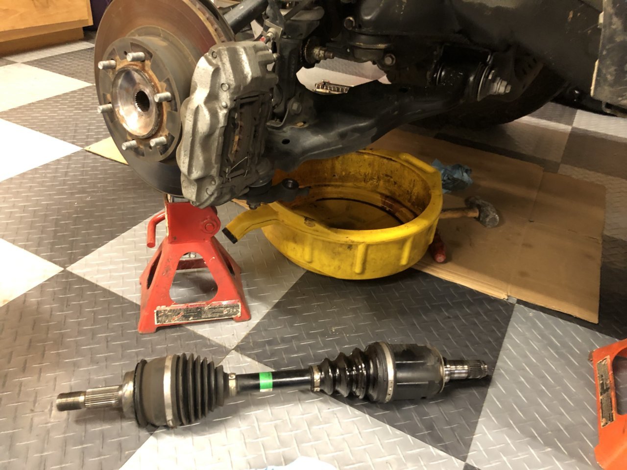

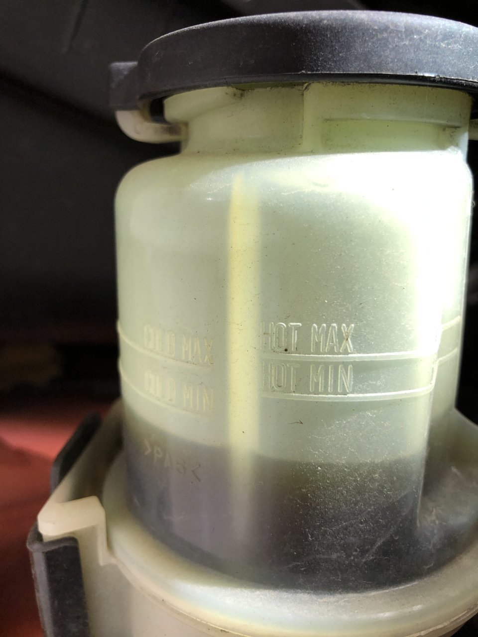

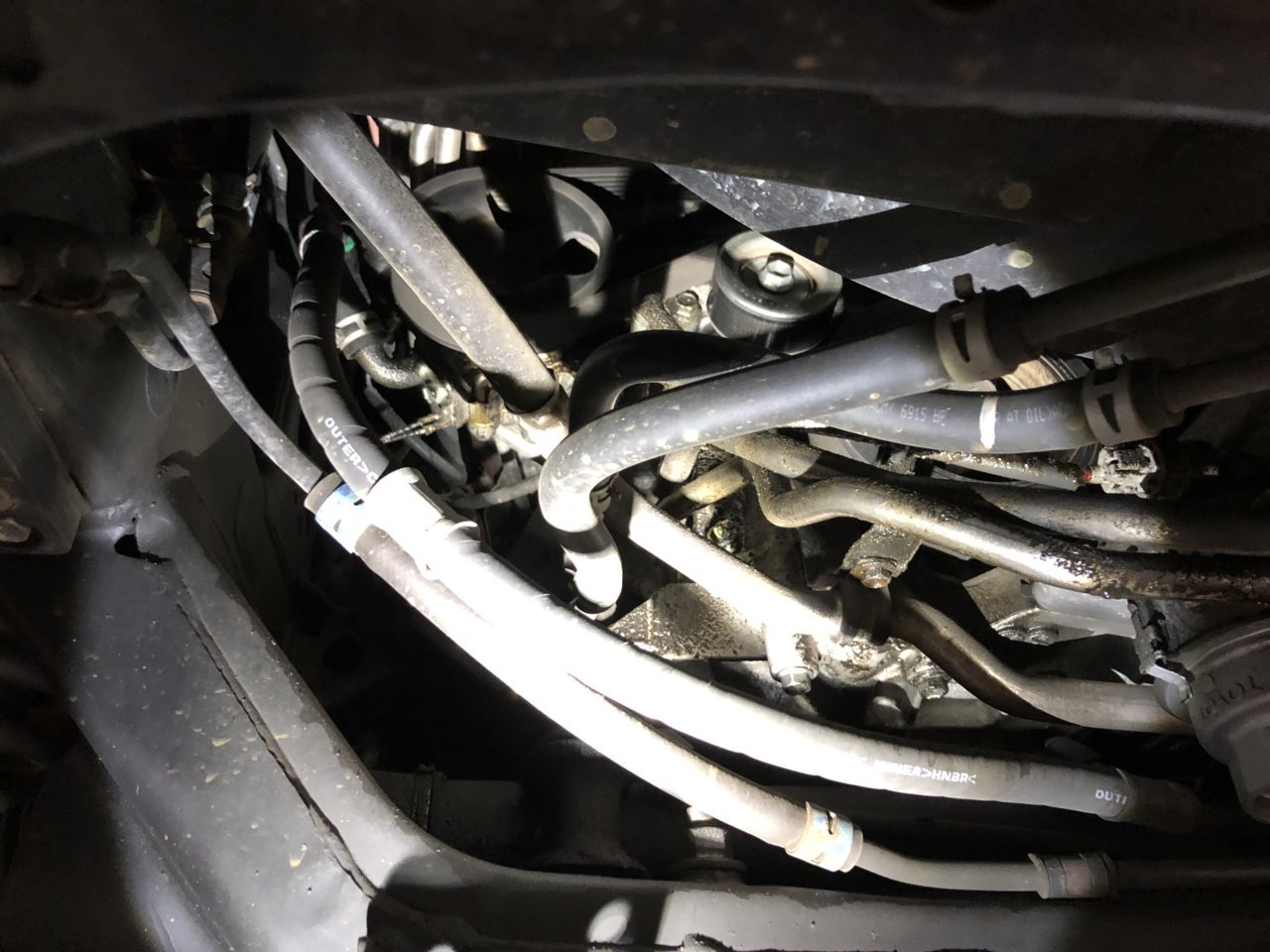

    Replacing my left side CV shaft and upgrade to the ECGS bushing. When I dropped the skid I see oil on the right side and looks like the power steering pump. I read this post and now looks to be the timing cover. The power steering fluid is low so I'm going to clean up all the mess and see where it's coming from.

    I haven't looked that close at my Tacoma, but how does a timing cover leak power steering fluid?

    The leak looks like its coming from the PSP but this post is saying it could be the timing cover. I'm thinking it's the timing cover also after cleaning it up and looking closer at it.
