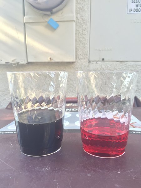

    The steering on my '98 Prerunner 2.7 Liter has been sluggish for a while. I looked at the color of the fluid and it's colored like a dark burnt sienna. I wasn't even sure the truck had power steering until I looked under the hood (that's how sluggish it is to turn). The pump could be bad, I'm not sure how to tell.
    I looked around on the forums a little bit and I found out you're not supposed to use power steering fluid, but instead automatic transmission fluid. Is this correct? I don't understand why you'd use ATF instead of something actually made for power steering specifically.
    What's the correct power steering fluid type, and how do you tell if the pump has gone bad?

    The manual calls for Dexron II or III ATF. That's what I used on my 2003 PreRunner. I used the poor man's turkey baster method to suck the fluid out from the reservoir. Just be careful with the mesh filter on the bottom of the reservoir. Then I refilled the reservoir, drove in zig-zags down the street turning the steering wheel from lock to lock, and repeated the process until the fluid looked clean. I'm not sure what the symptoms are for a failed power steering pump. I'm sure others will chime in.

    Before you buy a pump, you should check the mesh filter that's at the bottom of your reservoir, might be clogs
