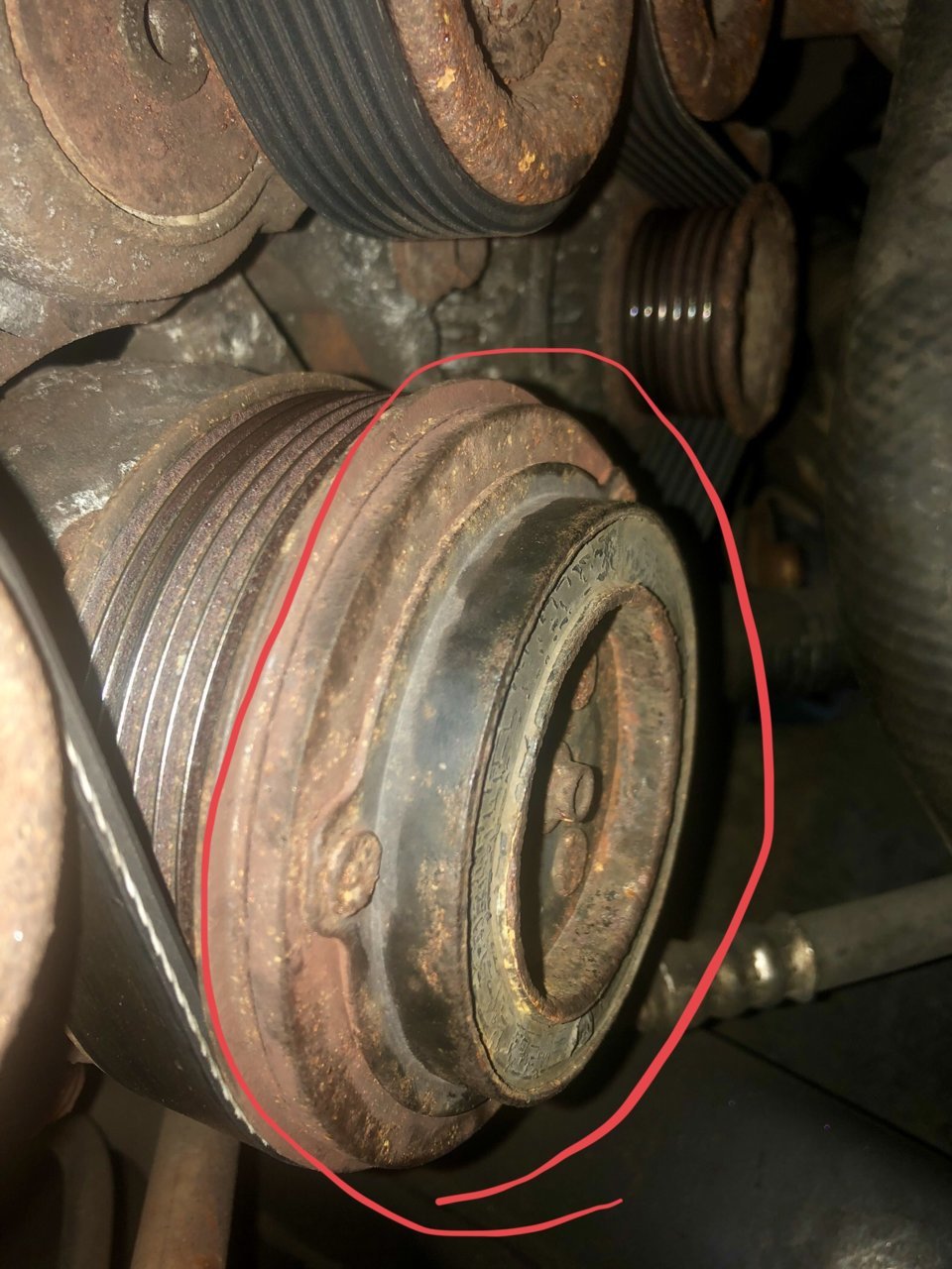

    Actually, what are the odds it’s the ac pulley? Even though I’m quite sure it’s the PS pump due to the fact that it looks like liquids all over the side of it. No it’s not leaking, I’ve kept an eye on the fluid.

    Is the circled part on that AC pulley supposed to move separately from the rest of it? I’m stil not fully sure where the noise is coming from. I thought it was the PS pump, but I’m not quite sure anymore.

    Sorry for trying to help ya fella. Hard to hear your noise over the internet. Looks pretty crusty in there. Hope you find your problem.
