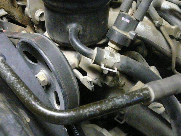

    If it helps, here are a couple of photos of my PS pump ( 99 Tacoma 4wd 2.7L)

    Never replaced it. It does groan once in a great while when turning sharp right.
    My idle-up switch connection looks a little different.

    Yea ours has two vacuum lines on the banjo high pressure line, the one I'm wanting to put on had an electric switch. But hopefully my banjo bolt fits and threaded the same. That and the pulleys are different. This one has bigger holes so you can actually take the reservoir off without having to remove the pully to get to that one bolt on that side.
