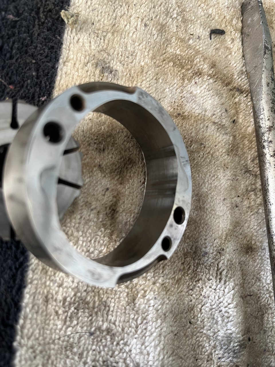

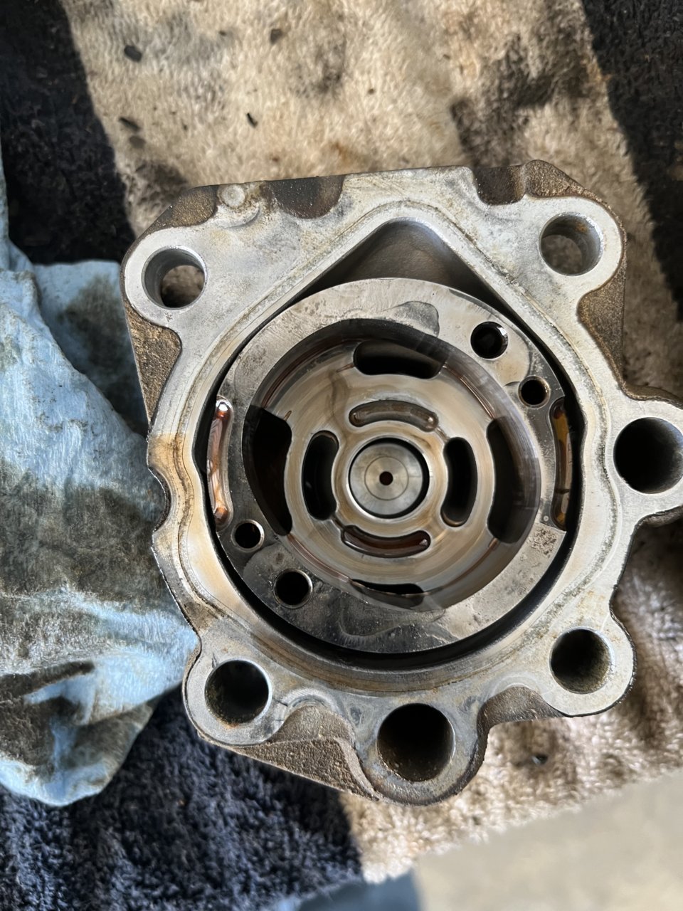

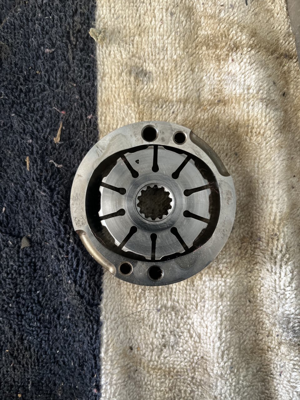

    Attempting a power steering pump rebuild on my 99 3.4l. Is this part supposed to be oval shaped? Looks like it has been worked into an oval. Started as a circle? Pretty scored around the whole thing as well.

    BTW, if that part ended up oval shape you are probably going to need a new one anyway

    Well after looking at how much the ring is grooved I’ve decided to get a new one. I was able to source a car quest “new” one. The only reason I thought I would just rebuild it is because most aftermarket remanufactured pumps are hit and miss coming from reviews at every parts store and a lot of forums. Oem is obviously going to be the best but can’t save this one sadly. They make a $20 seal kit which I was planning on using to save some money. Oem new pump is $338 from my local dealer. Hopefully this carquest one will do the trick seems to be good quality.

    to answer your question... yes it is supposed to be oval shaped. That is how the fluid gets pressurized.

    Thank you! After looking mine over it has some pretty big bumps and scoring inside of the oval so I think replacing the pump would be a better option. Going to add an inline filter as well.
