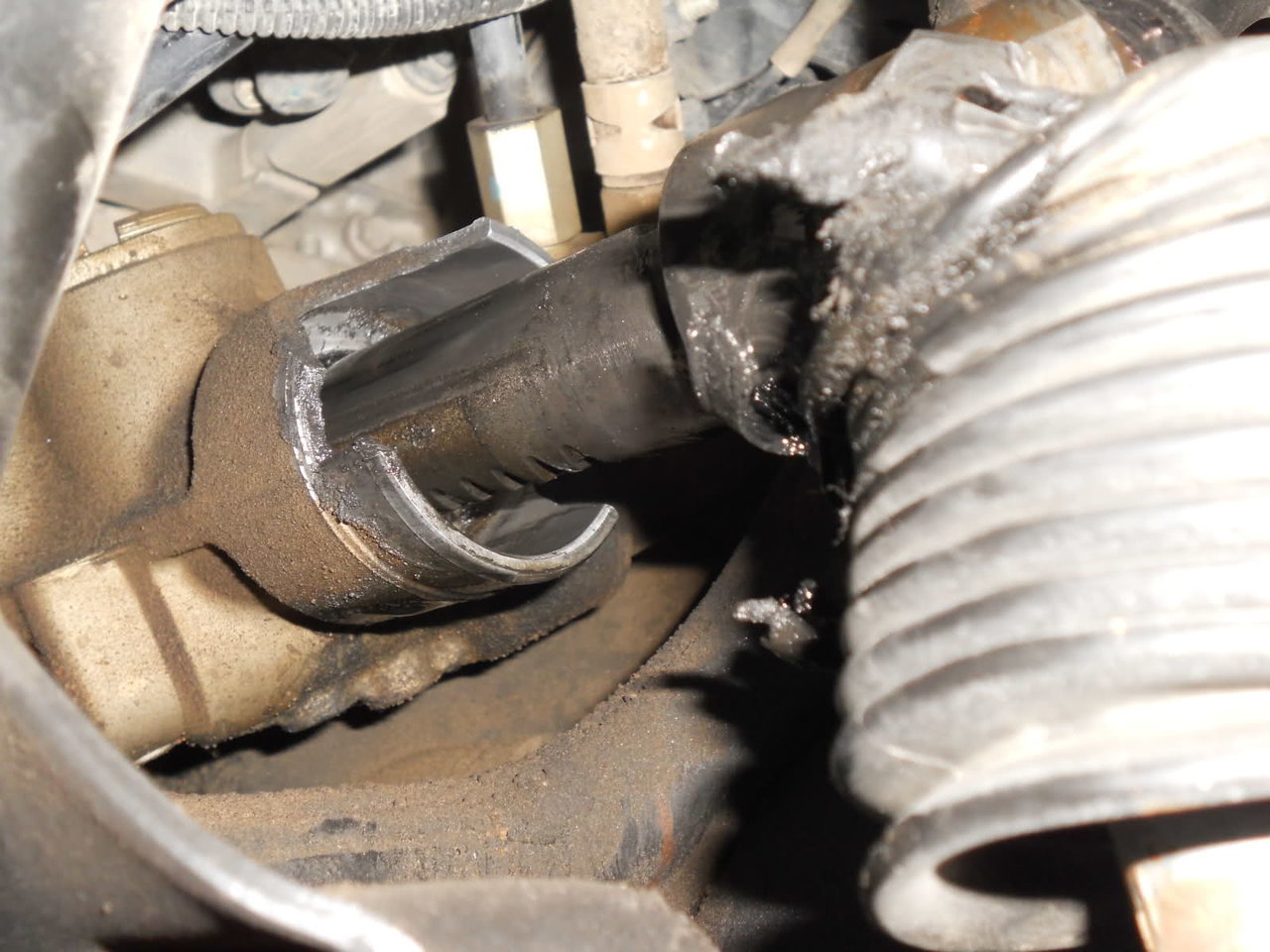

    here's how mine is looking:eek:

    Yep, mine looks just like that.
