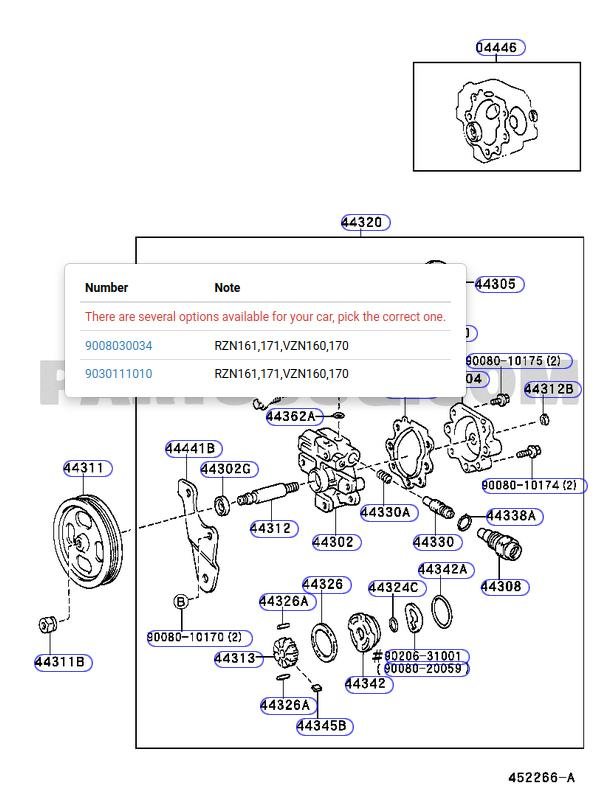

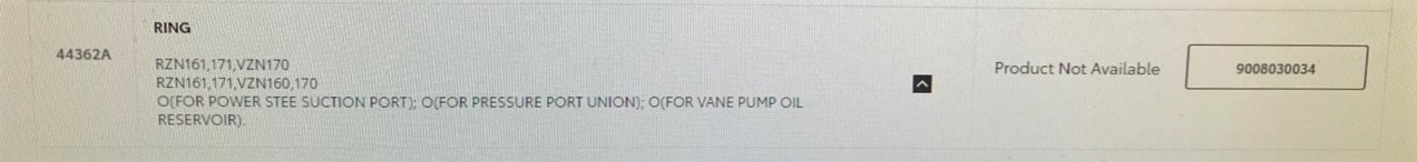

    Perfect! 44362A in the diagram is the 90080-30034 O ring that goes on the bottom of the reservoir & the one I am looking for. It was marked OOS at McGeorge when I placed my last order just 2 weeks ago and NOT AVAILABLE at Toyota online. I'll get a few just to have them in hand. Appreciate the help!
    EDIT: There is some confusion on the McGeorge website on this O ring. The McGeorge website shows the 90080-30034 O ring does not fit my '97 V6 Taco. The McGeorge info looks to be questionable, possibly in error. The below info is from the parts.toyota.com website which shows the 90080-30034 O ring is the correct part for my VIN:

    The (2) O rings being discussed here look to be specific in their application. My '97 V6 Taco was built 01/97 so it uses the OEM 90080-30034 O ring. Check your VIN when ordering.

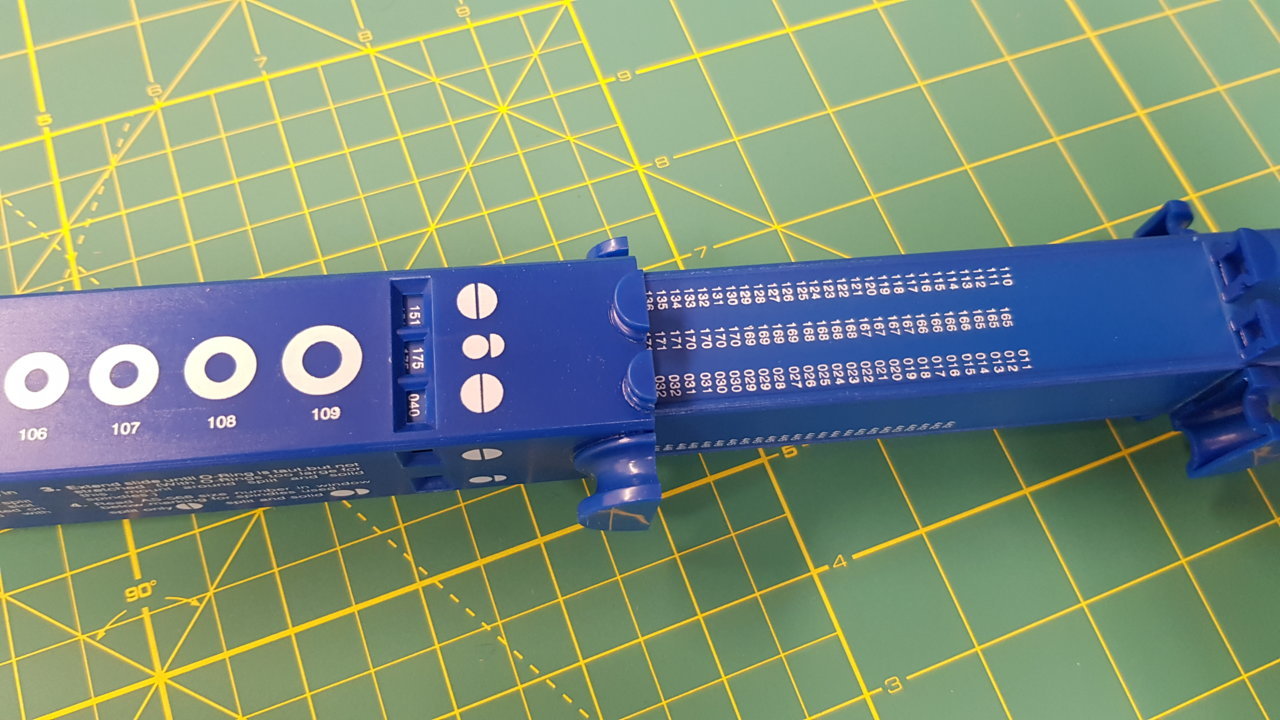

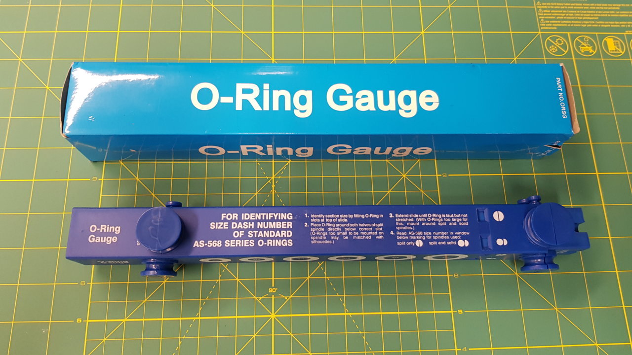

    Is it a special shaped o-ring or just a plain old standard round profile o-ring? If the latter, I wouldn't buy from the dealer, just match up the size & buy it in the appropiate material if it's not common black buna-n.
    If you have trouble matching up the size, get one of these. They don't cost much & comes in very handy, especially sizing large o-rings.
