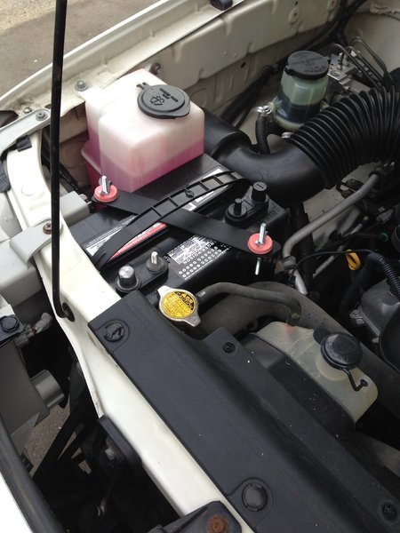

    I have been planning a dual battery install for some time now. I really don't like stuffing two batteries in the stock location, tight to the headlight socket, and adding even more weight to the drivers side.

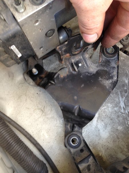

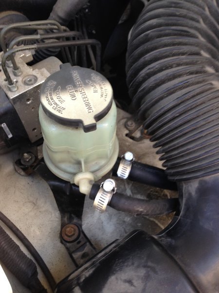

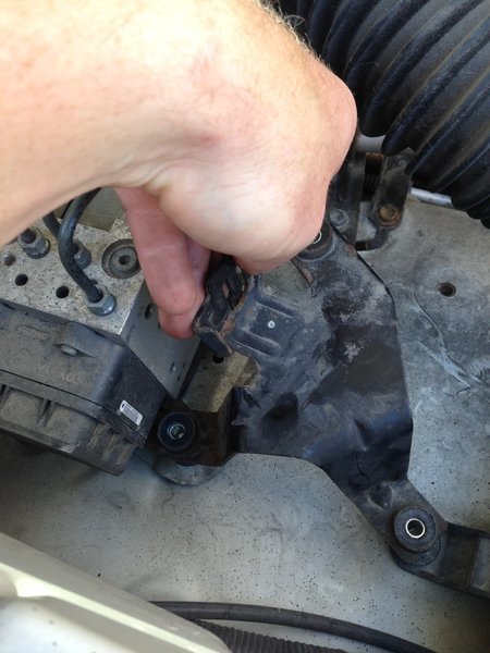

    Leave the reservoir there and check the fit of the bracket between the abs and air box mount
    The bracket will fit between these two mounts, one leg just needs to be adjusted a little further towards the abs mount. I used a small vice to change the bends.
    Once you remove the rubber spacers from the reservoir bracket its fits perfectly between the stud and threaded insert.

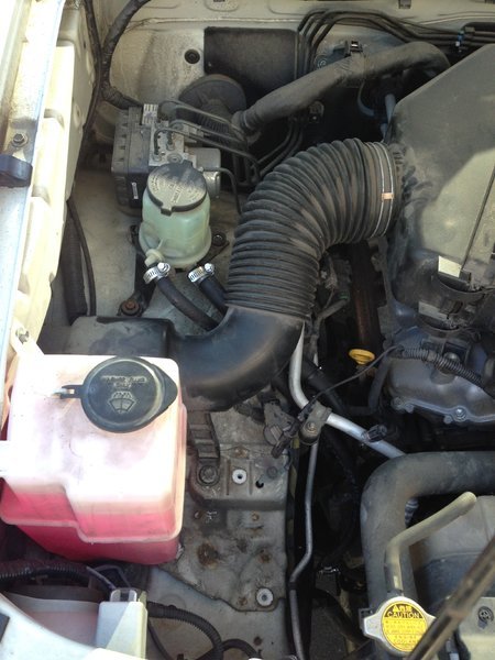

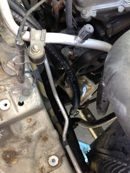

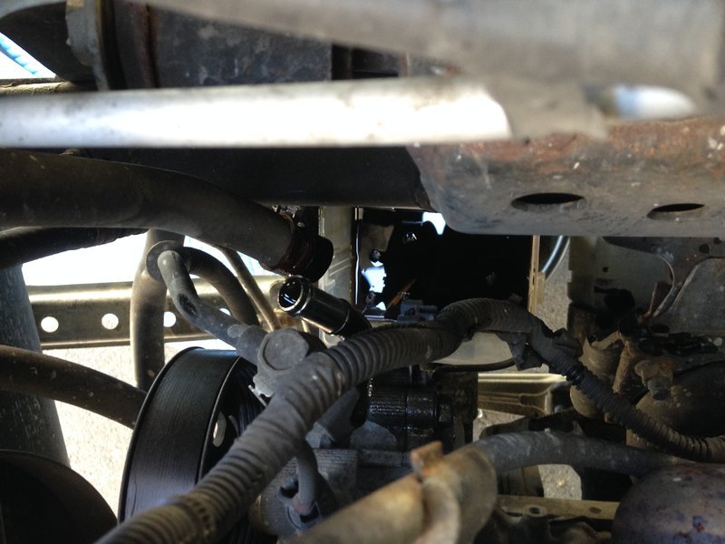

    Next I pulled the skid plate to get access to the hoses from underneath. First I removed the 5/8 hose and let it drain into a pan. Still made a mess because there isn't a direct route from the hose to the drain pan. image.jpg
    Install the new hose and tighten the clamp. Repeat the same steps with the 3/8 hose so you have two new hoses routed up between the AC lines
    Next I removed the air intake hose to get better access to the reservoir hose barbs.
    Cut the hoses to length, re install the reservoir and tighten the hose clamps.
    I chose to insulate the hoses wherever they made contact with the AC lines by splitting a piece of extra hose, sliding it over top and zap strapping in place to reduce movement and rubbing.
    Re install the air box hose and it's almost finished.
    Bleed the system by jacking the front of the truck up, fill to the cold max and start the engine.
    The pump will draw in the fluid it needs, fill it up again and start turning the wheels lock to lock. Once the fluid stops dropping the system is bled. Top up fluid and you are finished.

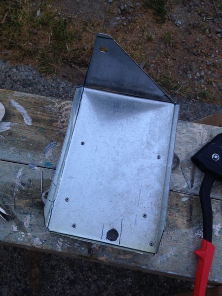

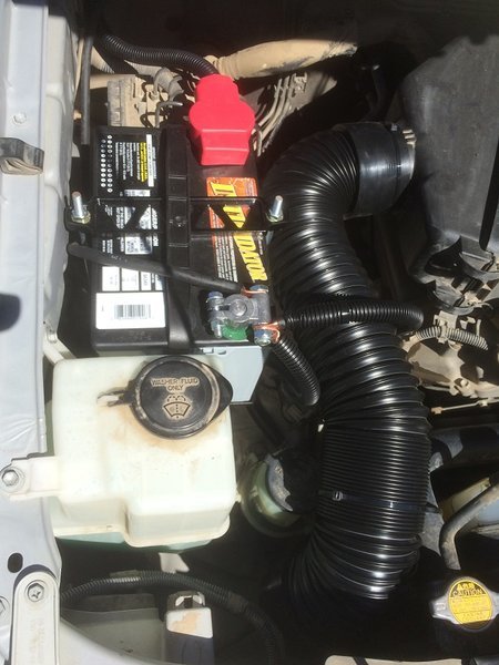

    image.jpg Bent up my battery tray from some heavy gauge steel stud at work.
    Got that mounted where the PS reservoir was. With a shoehorn and some choice words, I got the battery in there
    Pick up my blue sea ml ACR tomorrow, then i can start to wire it up.
