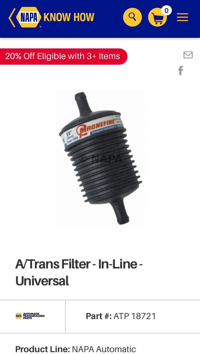

    I’d install a magnafine power steering filter as well. It easily attaches inline on your return line to your reservoir, and is equipped with a magnet and a filter element. I personally have one on my power steering, and transmission.

    About the size of a fuel filter? Nice!
    I'm assuming the filter is Power Steering fluid spacific? Would I have to order the filter? Or do parts stores stock it?

    It’s about 25 on Amazon and it’s agnostic to the fluid as long as hydraulic

    I bought mine from NAPA, they had it in stock. It’s spec sheet says it can be used for either power steering, or transmission. If the filter media stops up, it also has a bypass. I use two of the same part number. One on my p/s and one on my transmission.
    Back when I worked at the ford dealership, one of these came with every re-manufactured transmission that we installed. We rarely added them because we would be cutting a metal line to install it, and we were on flat rate. We just flushed the cooler, and let it ride.
    Our trucks have rubber hoses, much easier to work with.
    Yes, it’s about the same size as an in-line fuel filter.
