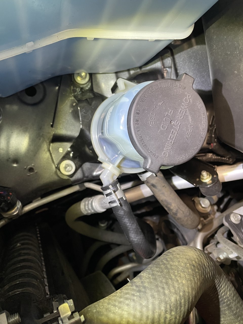

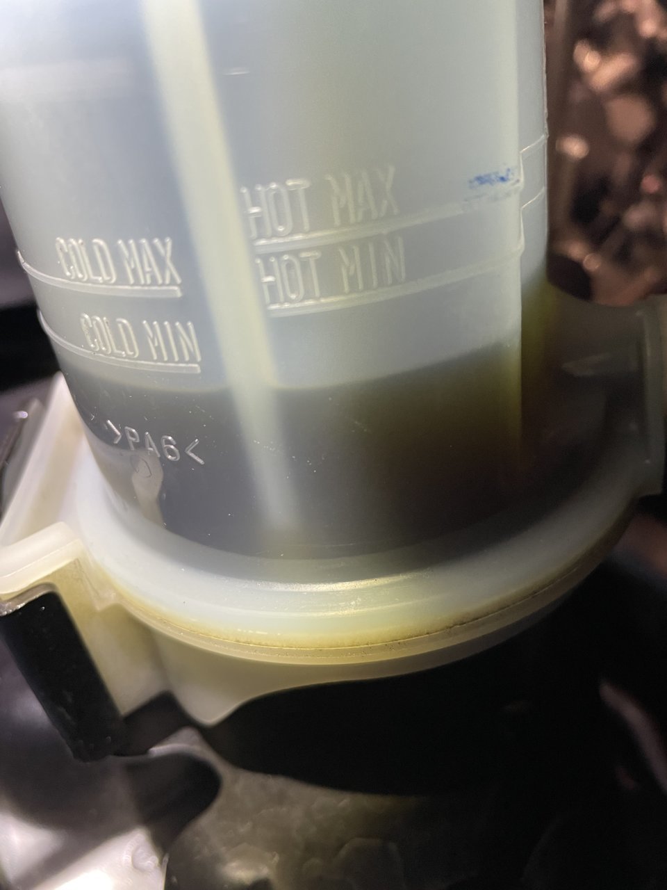

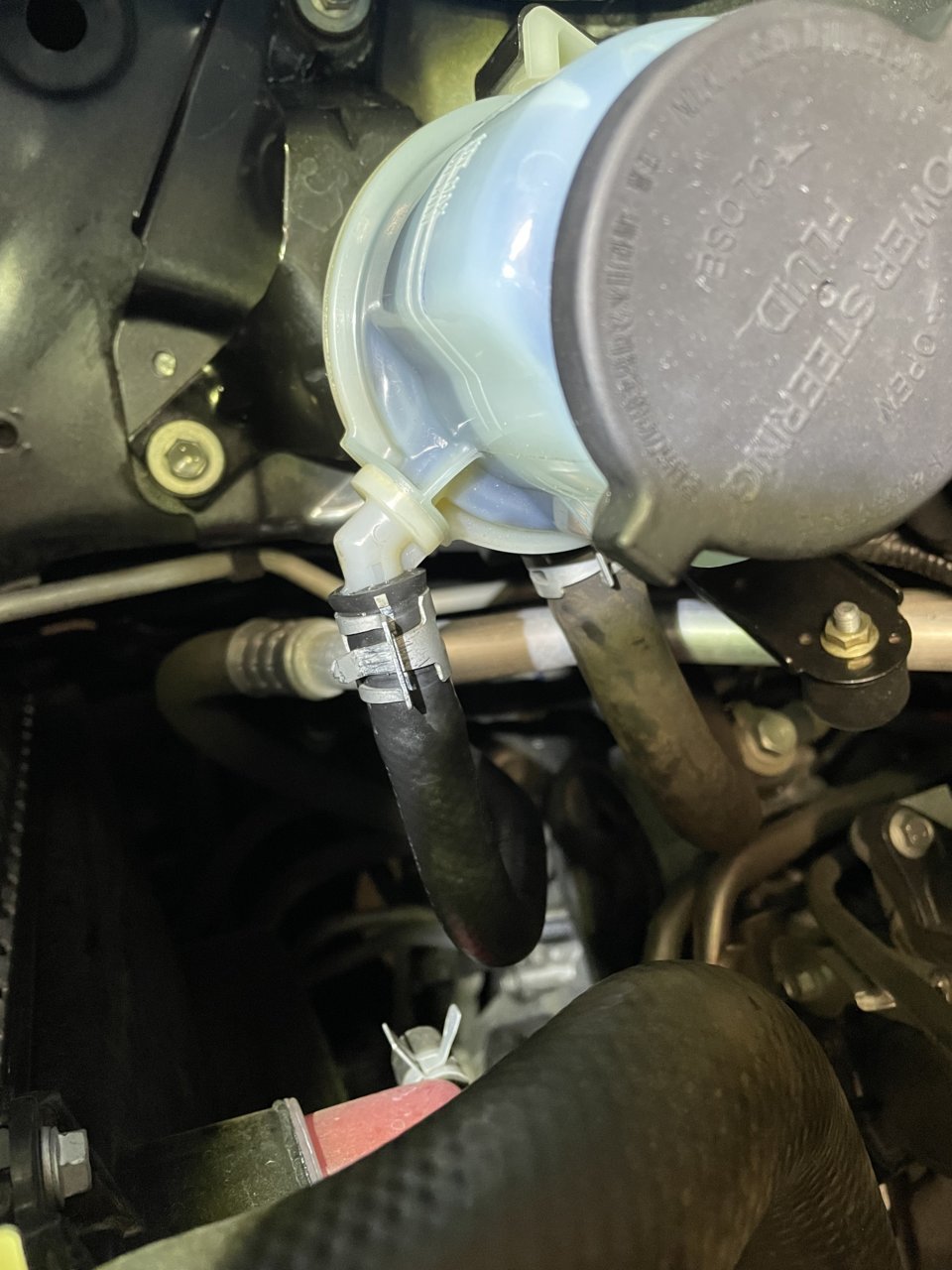

    I'm wondering if anyone else has had this issue. My 2017 with 17k miles has started leaking power steering fluid where the return line connects to the reservoir. (the top skinny hose connected to the 45 degree elbow on the reservoir) It's a slow seep and no issues or noises currently exist with the power steering system. I've cleaned it a couple of times and tried scooting the hose as far back onto the reservoir as possible. Going to get some hose clamps from HD tomorrow to see if that helps.

    I was able to rotate the hose and clamp on mine a little and it's been holding since. Yes, the hose is one piece and it goes all the way to the rack.
    I don't know the inside diameter size, but I'd imagine you could cut and splice a piece of hose with an inline power steering filter right before the reservoir return inlet and you wouldn't have to replace the entire line that way. You might also try hose clamps as opposed to the factory pinch clamps.

    I would not recommend fixed hose clamps, especially for lines that experience frequent temperature changes. As the plastic heats up, it will want to expand and may crack if the fixed hose clamps has no give. Then when it cools down the plastic shrinks, and it may leak as it no longer tightly sealed.
    I have seen it happen often from the coolant hose at the radiator fitting when users switch the tension spring clamps for screw style hose clamps.

    I believe 3rd gens have 2 lines (one going to the rack and one returning to the reservoir) , but it's connected as one piece? Same concept with rubber to metal line. At least that's what I vaguely remember when I looked up the replacement hose piece. I think it was around 200ish for the factory line maybe more.
    Good to know. If they're snug, but not gorilla tight they'd probably be fine. If the factory pinch clamps aren't worn out they could ideally be reused.

    You could take the hose off and check that there aren't any burs on the plastic barb. Plus reinstalling the hose and clamp might re-seat it better
