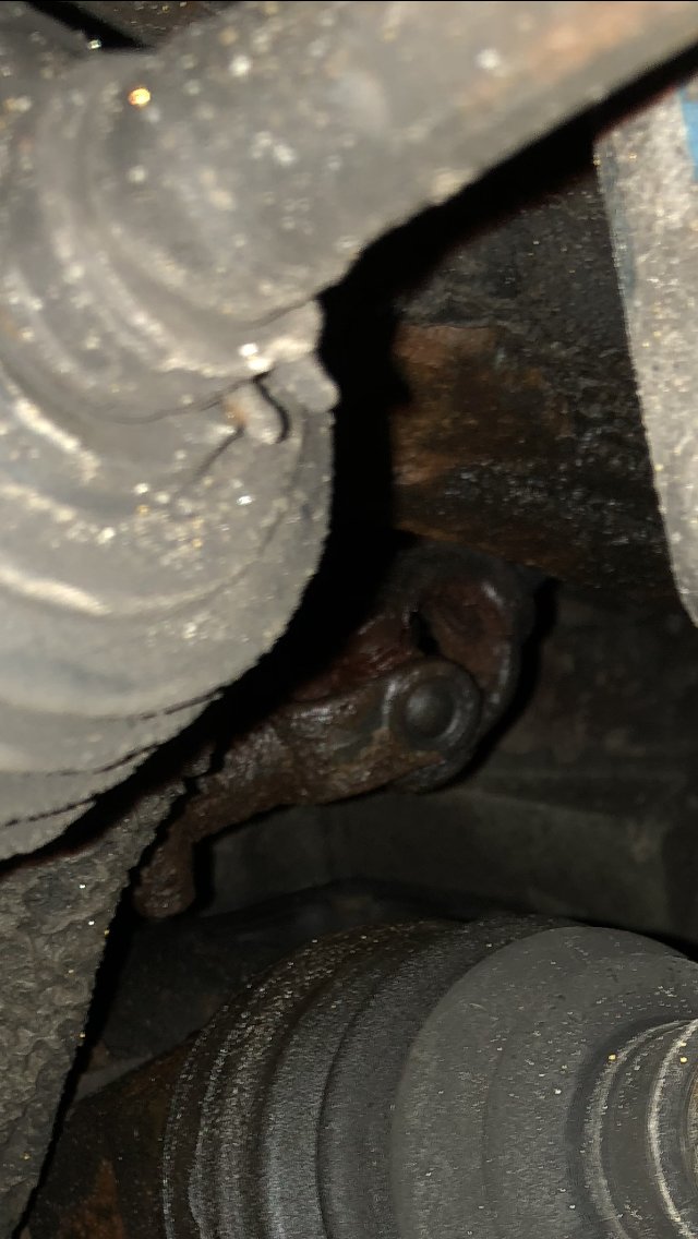

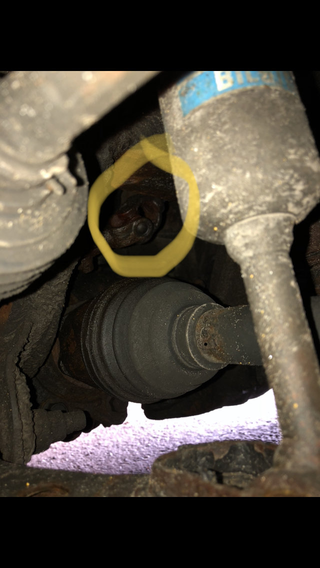

    There is a knuckle on the lower intermediate steering shaft that rusts and binds.
    It is visible drivers side, turn wheels hard left.
    475E6AA0-5709-481C-9000-146D97BEF71E.jpg 47460BEF-8C9E-4AEF-803D-F6FDC910D3A0.jpg
    Could try using some penetrating oil to see if it helps.

    I’d bet a beer it’s the u joint. Just spray it good with some pb blaster.

    what is Toyota part number? are both knuckle and steering rod replaced?
  10. Apr 23, 2019 at 8:51 AM
    TireFire
    TireFire Superunknown Member
    Feb 6, 2016
    #177349
    7,667
    Olympic Peninsula
    This whole thing is sold as one assembly from Toyota, called lower intermediate steering shaft #2. Costs about $300.
    However, several folks on here including myself have rebuilt it using a greasable aftermarket u-joint. Costs only $20 and much better than OEM. See here:
    https://www.tacomaworld.com/threads/2nd-gen-lower-steering-shaft-rebuild-diy.543377/
