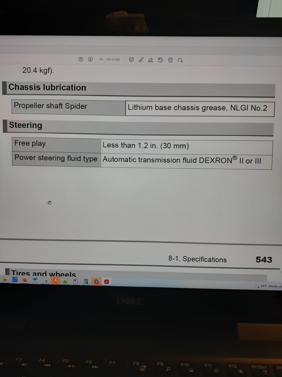

    Thanks, good description there, don't think I've ever done this, going to do it on the Tacoma though.
    My question is, which fluid satisfies the owner's manual specs? I've looked around and there's plenty of dextron vi. Nothing says II or III.

    Then crank the steering wheel slowly from center to 75-80% to the left. refill reservoir with new ATF Dexron III fluid.

    I found Dex III at Autozone, it was their generic no-name brand. Lots of people run Dex IV with no complaints.
