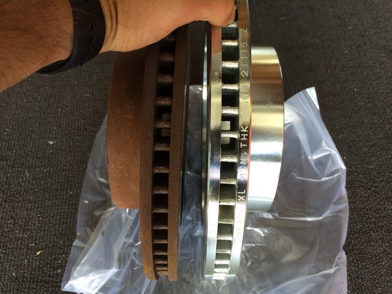

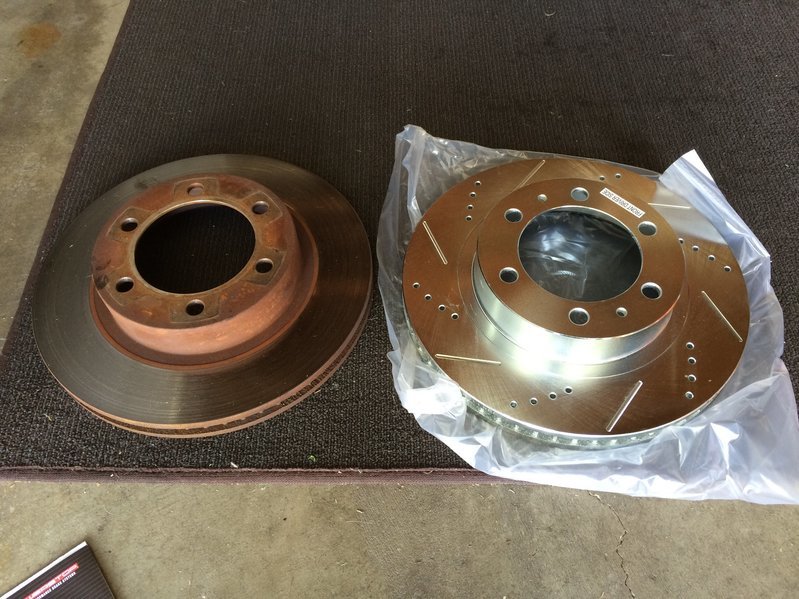

    What are your initial thoughts? Notice an improvement right away?

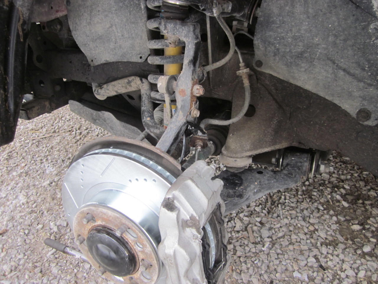

    So far no noticeable difference than what I had on there, but I'm sure they will settle a little more over time. Ill be doing some mountain driving next week that should be a good test.

    Drove through some mountains the past few days. Descended about 6000ft in 20 or so miles on the way back. Brakes are quiet and strong. Didn't really feel any fade towards the bottom of the mountain either. So far so good.

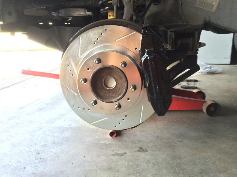

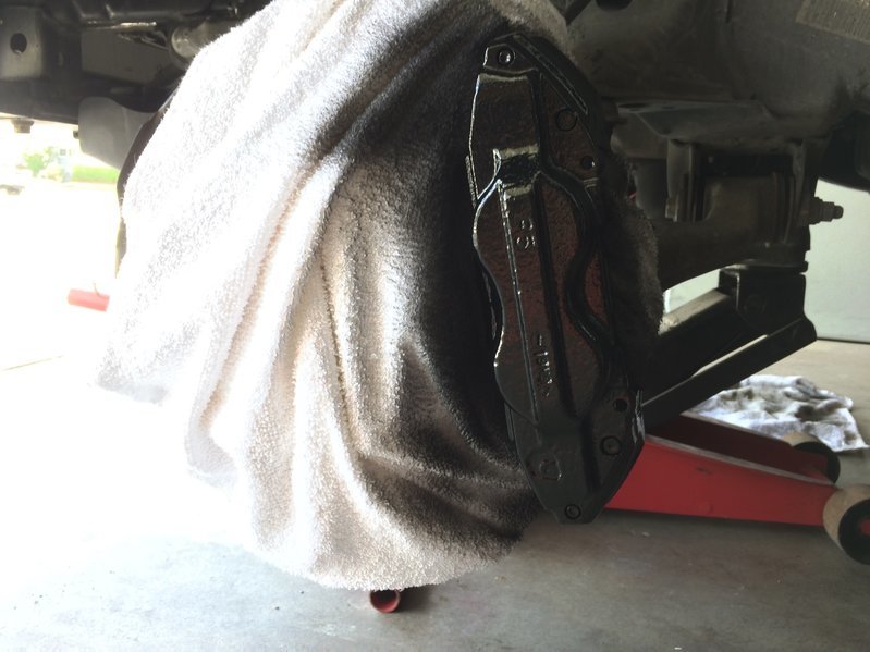

    Nice!! I got the same brake rotors and pads too - very satisfied ! I like how you took it up a notch with painting the caliper black!
