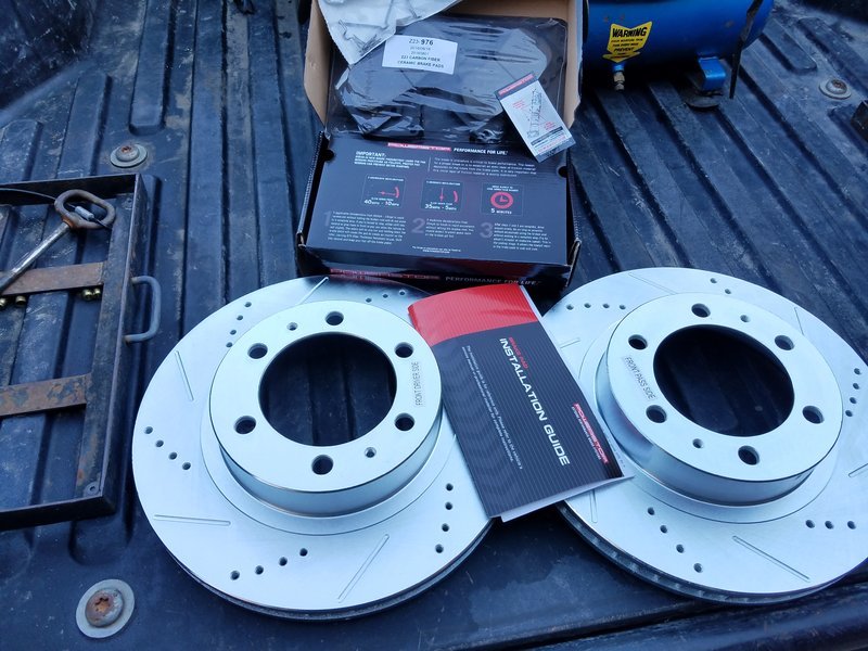

    I was pretty impressed with mine when I opened the box.
    So I just went and retrieved my box not sure why I still have it but oh well. I was mistaken the box is correct to the web instructions. The installation guide has the differing version.

    The instructions included are pretty decent also for those who were looking.

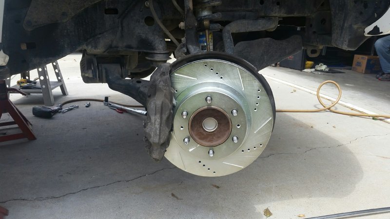

    @HawkShot99 the install is super easy. I think getting the brake pad retainer clips out & back in was more confusing than anything, I had mine upside down after fighting with my needle nose pliers. Take a pic of the brake caliper & pad before you take the clip & pads out, or just do 1 side at a time and run to the other side to check how it goes back together. Depending on your climate, vehicle mileage, age, etc your rotors may be frozen on the hub. You can tap the back side of the rotor with a hammer to bust it off or use the threaded holes in the rotor to screw a bolt in and "push" them off. Make sure you only do a few turns of the bolt on each hole at a time, that way the rotor doesn't get crooked on the hub & jam itself up. Props to @MonkeyProof for his pic :D
    Here's my War Machine after getting the new rotor slid on. Seen 1 seen em all but who cares, it's mine :rofl:
