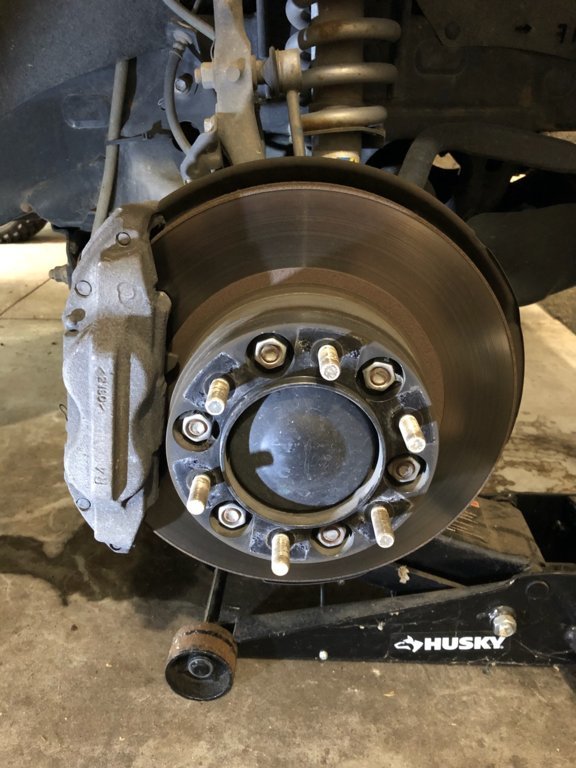

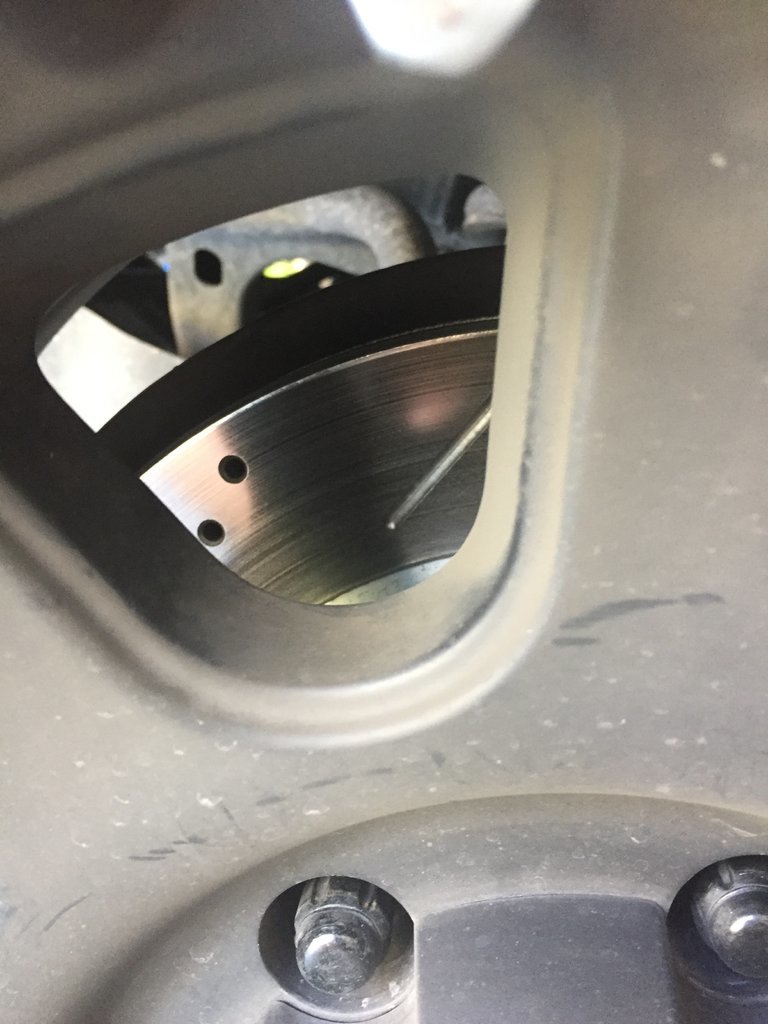

    Stock OEM
    PowerStop
    Btw I have BORA 1” spacers installed.

    Looks great will this last as long as oem? My steering wheel shakes when braking

    Don’t know but hope so. My OEM rotors still has some life left. I had my pads changed by the Dealer at 55K but these still had life left also. I’m at 110,000...but I downshift my auto transmission when I slow down so I probably don’t use my brakes as much as I should.
    But I will say, the PowerStop Rotors visually look well made and designed. All drill holes were properly placed between air veins. Holes and slots are beveled. The 20 miles of bedding driving I did, they seemed to stop better the hotter I got them and when I ran an errand the next day, they stopped my truck quickly.
    So, so far, so good.
