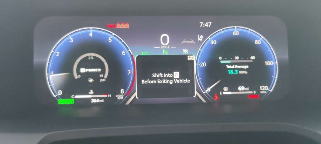

    @snickers, would you post a screen grab of the ON or OFF engine delay?

    With vehicle ON and in Park and e-brake engaged, at any time when the driver's door is opened this menu pops up:
    In same condition but in Neutral, you get this warning:
    Amending the original post to reflect correction of Neutral state.

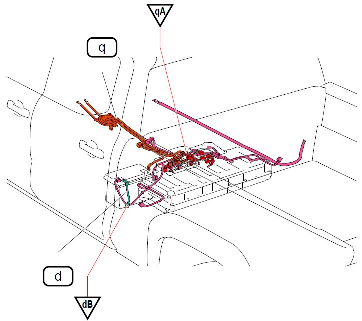

    is battery and cell more on driver side?

    12V battery under left side backseat. EV battery under right side back seat.

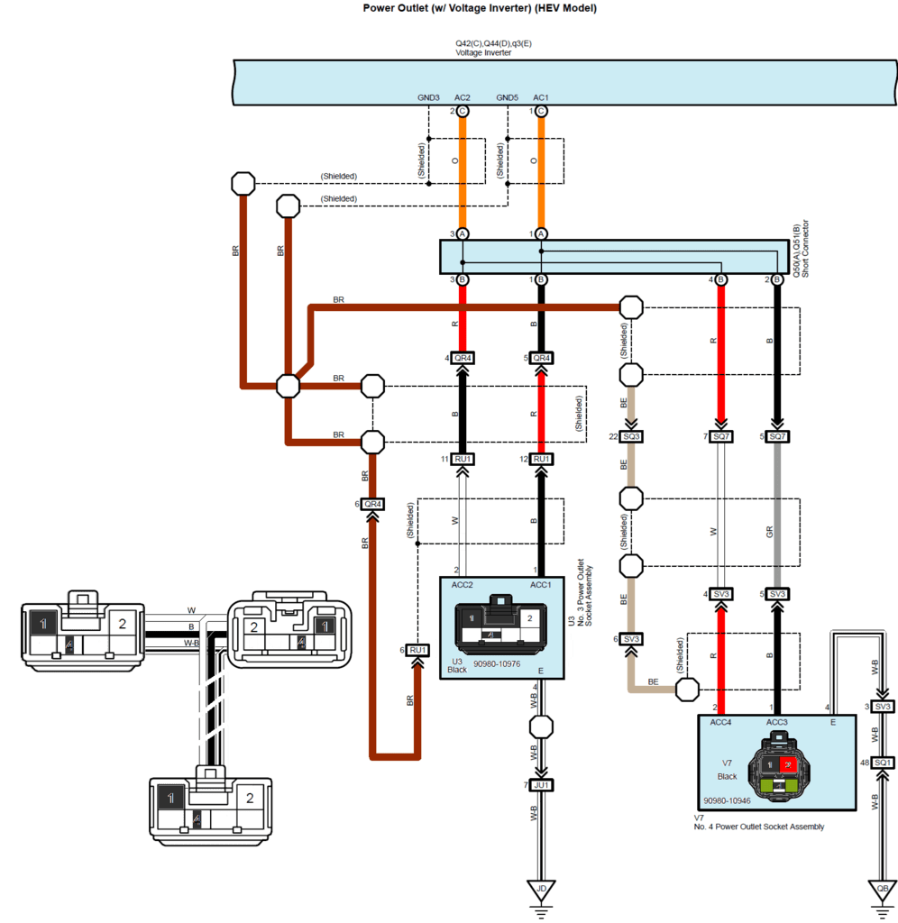

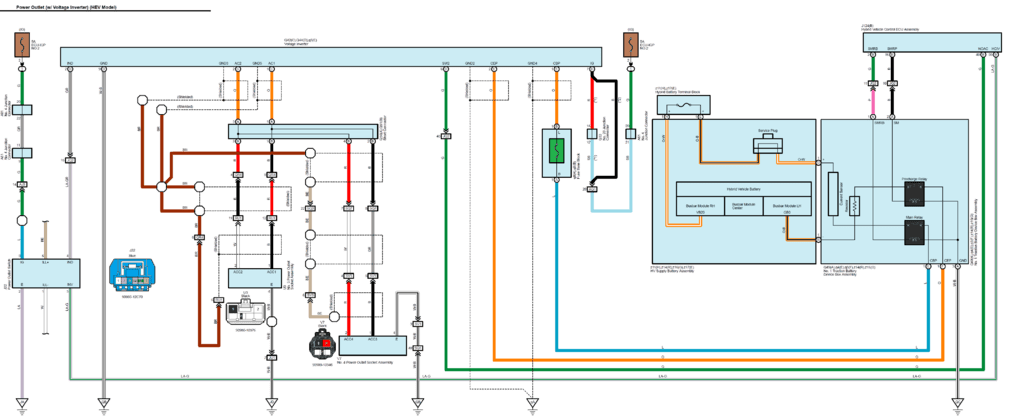

    OK, according to the schematic, the juice to the inverter is indeed supplied by the EV Cell. But I don't have any info on the specs of the inverter.
