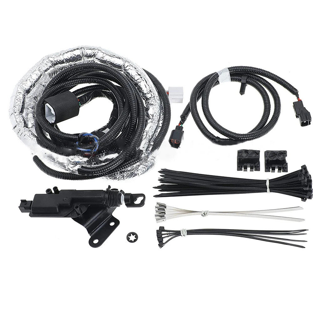

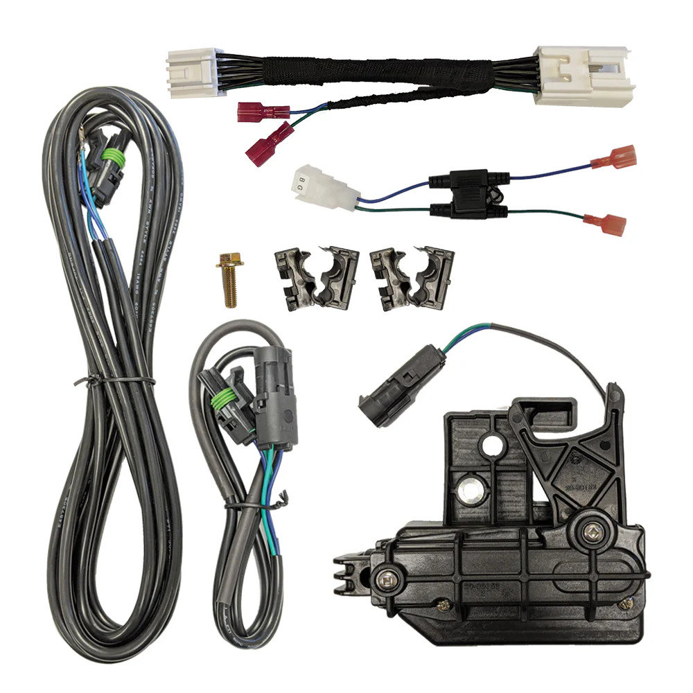

    For those are comparing OEM to Pop-n-Lock. The OEM version is on the left and the Pop-n-Lock is on the right.
    I have used both but IMHO the OEM version has better components.
    DES2009 likes this.

    I just installed the Pop & Lock a couple days ago. Took about an hour to install. I've heard the OEM is a bit quieter when locking and the harness is plug and play vs the Pop & Lock which includes an additional harness connection. Probably all about preference. At the end of the day, it locks your tailgate
    itsnotatoy likes this.

    The OE kit also doesn’t have extra harness length that needs to be bundled up and stuffed somewhere.
    DES2009 likes this.
