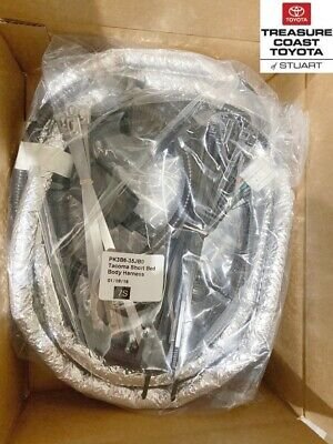

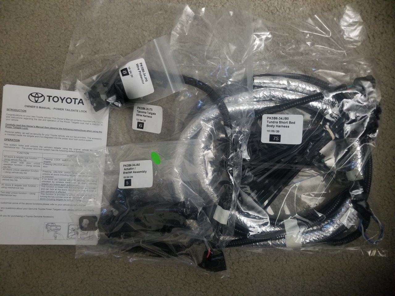

    I ordered and received the OEM from OEM Part Source. But the harness included is labeled "PK3B6-34JB0 Tundra Short Bed Body Harness". Did they send me the wrong one? Or is this just as compatible?

    Also, where can I find the Installation Guide for this kit? Or did you guys just follow that video?

    Post 4 has the instructions. Not sure about compatibility.
    Edit:
    It looks like each bag you have has a different part number, like a component or sub assy part number. Is there a higher level part number listed on the receipt or a main bag or box?

    Does yours have an outer box with a part number like this?
    https://www.tacomaworld.com/threads/2019-tailgate-lock-pn-pk3b6-35js0.637471/page-15#post-22866531
    Looks like someone else received a tundra one.
    https://www.tacomaworld.com/threads/2019-tailgate-lock-pn-pk3b6-35js0.637471/page-27#post-24263848

    Looks like -35JBO on this one. I'm leaning towards that's the wrong one you have.

    Well, I contacted them and they validated that this is the correct kit based on my Taco's VIN. Here we go!!
