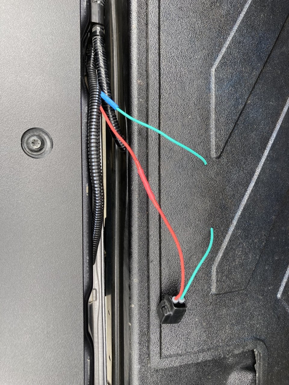

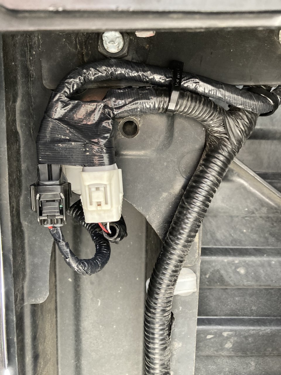

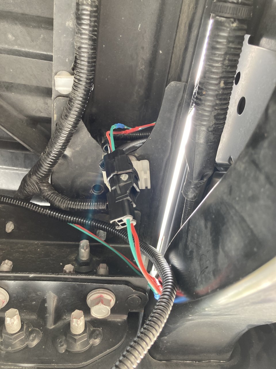

    I noticed this as well and I’ve written about it elsewhere. I believe the harness manufacturer made a mistake with the tailgate to body harness connectors and put them on the wrong sides.
    I swapped mine so that it matches the camera. As a result, the body harness connector (which used to be on the tailgate side) locks into place on the plastic tab which holds the camera connector and the tailgate connector secures to it without any zip ties.
    I consider this a rather amusing mistake where someone decided to just say “f it, good enough” somewhere down the line. But it’s super easy to swap with heat shrink solderless connectors and some harness tape (or be careful and reuse the existing tape).
    Now that I’ve done a bit more crimping it might even be easy enough to de-pin and re-pin with reversed gender but probably not many have a weatherproof crimper and the correct pins and seals.
    A mod to the mod if you will. Or rather a pre mod since you can do it on the bench before the installation.

    I’ve thought about building an intermediate 6 pin connector harness so it would all be plug and play but it seems like a bunch of extra connectors for very little added convenience and the 6 pin might even be harder to fish though the rectangular opening for tailgate removal / reinstall.
