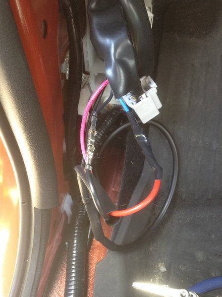

    Got the install done today... pretty smooth. I took after @Aznray and @adobe18 in finding a solution to not cutting/splicing factory wires. I used a couple male and female pins laying around from my JBL upgrade project. The pins came from the generic Toyota stereo harness for aftermarket stereo installs (Metra 70-1761 and 71-1761). I solder the pins into the Pop & Lock harness. I depinned pins 9 & 10 on the factory plug. Put the Metra male pins into the factory pins 9 and 10 and taped the together so the wouldn't come apart. Put the Metra female pins in the factory plug and taped them cause they were a loose fit. Connected the factory plug and everything works like a champ.
    This thread is very helpful on the general install. I think there is a Tacoma specific PDF from Pop & Lock in this thread somewhere (kit had instructions for the Tundra). I pretty much followed the Tacoma instructions and was pretty straight forward. I did heat shrink and tape the wire connections inside the tailgate... a little something extra. If I have sound deadening material left over from the speaker upgrade I might look into adding some to the tailgate but sound isn't any worse than my Ram 3500 with factory power tailgate lock.
    Depinned factory plug. Pin 10 is black and pin 9 is blue.
    Solder Metra Pins (one female and one male) to Pop & Lock harness.
    Final harness ready to plug into factory harness.
    Plugging Metra male pin into factory female. Then taped together.
    Final look.

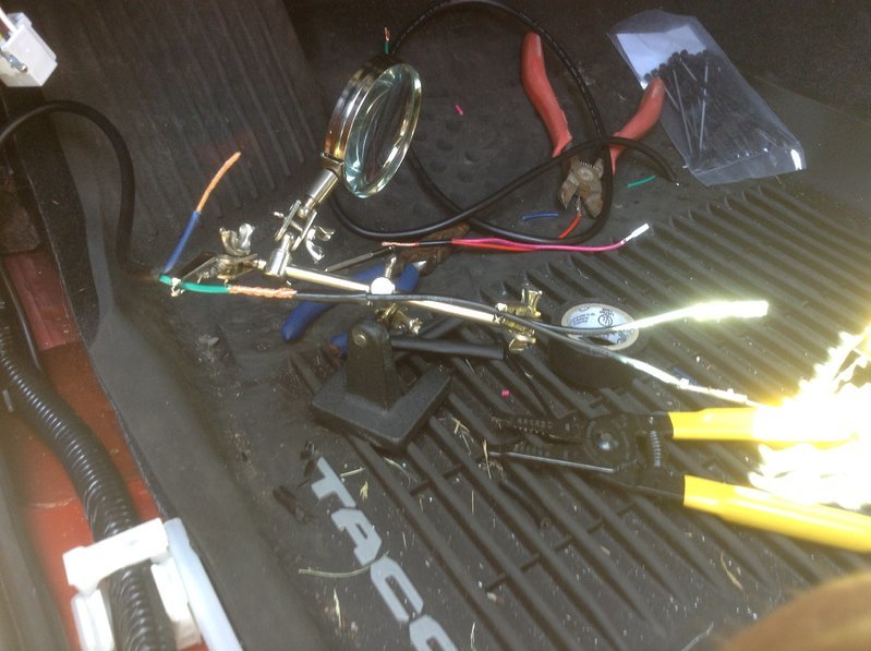

    So if I go to the passenger side kick panel I can have the tailgate unlock with the passenger doors? Where do I tap in and what color wires? Thanks!

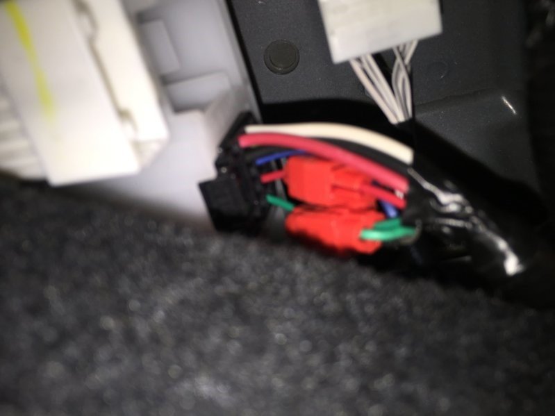

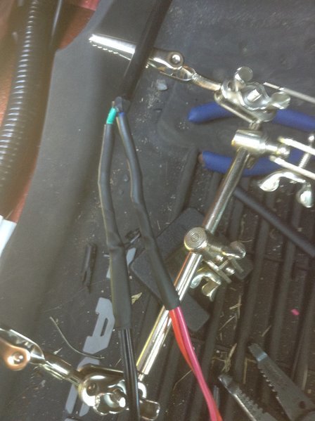

    Unhook the white connectors to get them out of the way.
    Connect to red and green wire at bottom black connector. Green to green, Blue to red.
    Passenger side front: GREEN-GREEN, BLUE-RED lock2.jpg
