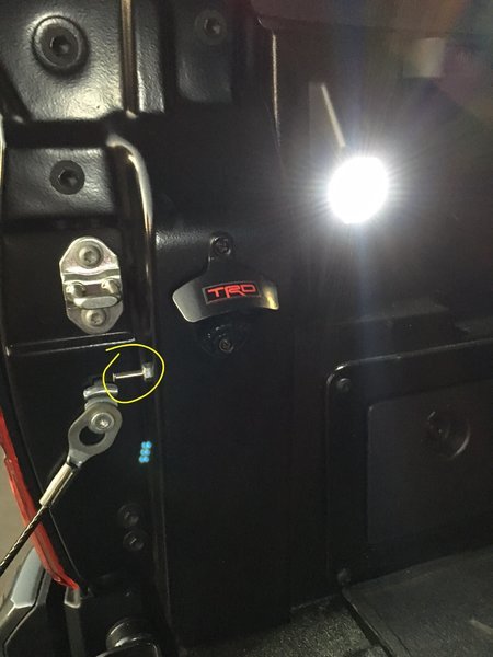

    The Tacoma tailgates do not have a trigger to set off factory alarm. You could tie in a universal hood pin to trigger one of the entry points. I'm using a hood pin in my tailgate to trigger my LED bed lights instead of tying to cargo lamp circuit.
    Let me know if you have any questions.
