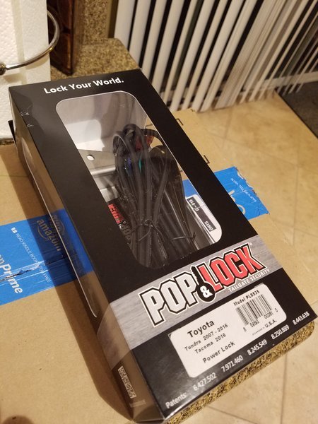

    Got mine!! New Year dilemma: football or install?????

    Easy, install the pop n lock. Or wheel a tv out to the garage/driveway and watch the game while installing. Just keep the beers to a minimum.

    Just got mine in yesterday form Amazon! $80 bucks and free shipping
    Cant wait to install this weekend along with my pro grill
