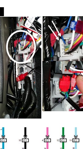

    Did mine yesterday. It's not prewired. I went Green to Blue and red to green using the top right white connector in the passenger foot well. Got it wired up and the lock button unlocked the tailgate and vice versa. Switched the bullet connectors and all is good.

    Did mine also and video instructions are backwards on the wires. Swapped the wires and worked perfectly.

    Yes the video is great except make sure you go green to green and blue to red. In the vid it is indeed reversed.

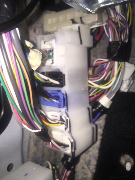

    I went to the drivers side like the factory accessory instructions said, but I don't see a 10 pin connector at the top like they are showing
    Anyone go to the drivers side instead and know what connectors to splice to?

    Unless I'm missing something, the plug on the drivers side kick panel isn't a 10 pin connector and looks nothing like the instructions.
    Anyways No big deal just went to the other side like the video...but I got everything connected, green to green blue to red and I get nothing
    Double checked the connectors and all the other connections.
    I don't have a meter so I can't test it
    Any idea why it's not working

    Popped in the pop and lock on my 2017 SR5 and it went well. Went in via grommet by front passenger seat, spliced connections to green and red wires on black connector behind passenger kick plate, green to darker green and blue to red and soldered them in for permanency. Also siliconed the grommet entry point. Got all of the ideas and tips from this thread. Thanks to everyone for their tips! Works awesomely!! Also, people complain about how loud it is, but it doesn't seem terrible to me. Sounds heavy duty. I kinda like it!
