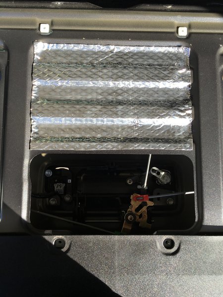

    Add a piece of sound deadening material to the sheet metal. Cuts the noise level down by half.
    ngtrd and Joe23 like this.

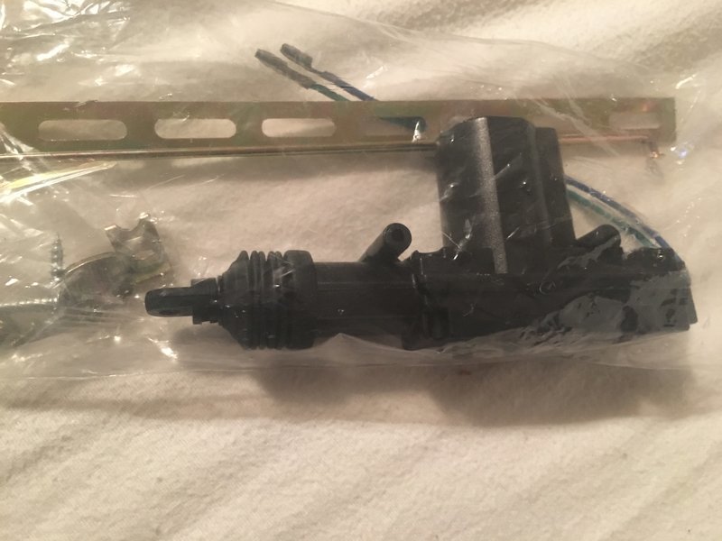

    I have an actuator with mounting bracket for sale - brand new!
    $20 shipped

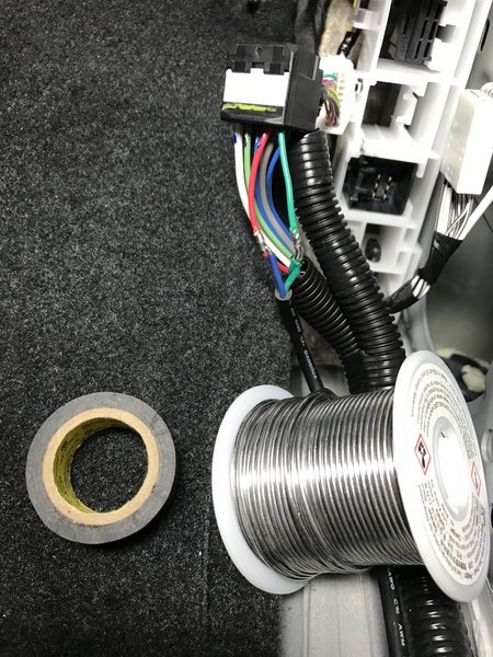

    I installed a pop and lock around noon.
    by 8pm it already stopped working.
    its dark so didn't look into it much, I'm guessing (hoping) a loose connection somewhere (thinking in the tail gate)
    gonna open it up tomorrow and see.
    it worked fine all day when I was out, then when I got home went to get stuff out of the bed, it unlocked I opened and then when I closed it again it stopped. Thinking maybe connection got shaken loose. gonna see if I can get it working and if it is that probably going to crimp the connectors a little to tighten them and add some heat shrink.

    That has been discussed several times in this thread. There isn't. Embrace the solid sound of security.

    Most likely it is the splice connectors in the cab. Give them a little twist to get a better connection.

    Tried that. Still didn't work

    Did this mod over the weekend. It took me one hour and cost me $5.00. Best mod I have ever done. Thanks for idea.
    Siblue and rrentrop[QUOTED][OP] like this.

    Those connectors that come with it are garbage. I had the same issue. Swap them out for some other ones. If you don't have any you can get a couple at RadioShack
    Joe23[QUOTED] likes this.

    Installed the Pop N Lock today and am very happy with the quality of the kit. Solder your connections people! Those clamp style connectors are garbage and should never even be used.

    mine wasn't working so I took it apart found the joints were shite, so figured I should take my time and do it properly and just solder it.
    no help from pop n lock though.
    rather disappointed I emailed them and now a week later still never heard back from them about it.
    Oh well...at least it's working now.
