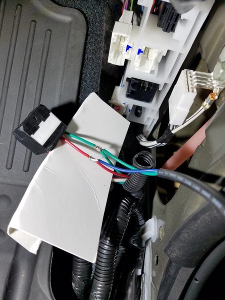

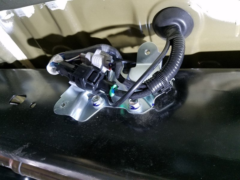

    Mine is finished! About 2 hours to install, took my time to do it right! The hardest part was getting my wiring harness back into those ##$%# plastic clips at the base of the tailgate to securely clip with the added width of the harness. Broke them both, but was able to get them to work.
    Solder the wires FTW! I don't believe in cheapo wiring taps that can/will fail over time.
    Getting the wire into the cab was a piece of cake! No need to cut that boot, just peel the existing electrical tape off, put a bit of white lithium on the boot, pull the wire through and then tape it back up. With the shroud bolted back on you don't even see the wire at all.
    I also got rid of those bullet connectors in the tailgate and soldered them:
    After hearing the P&L in action I honestly don't know what everyone is complaining about with regard to the noise of locking/unlocking. Sure, it's a muted "clunk" but so what? It's not that noisy and I don't understand what all of the complaints are about.

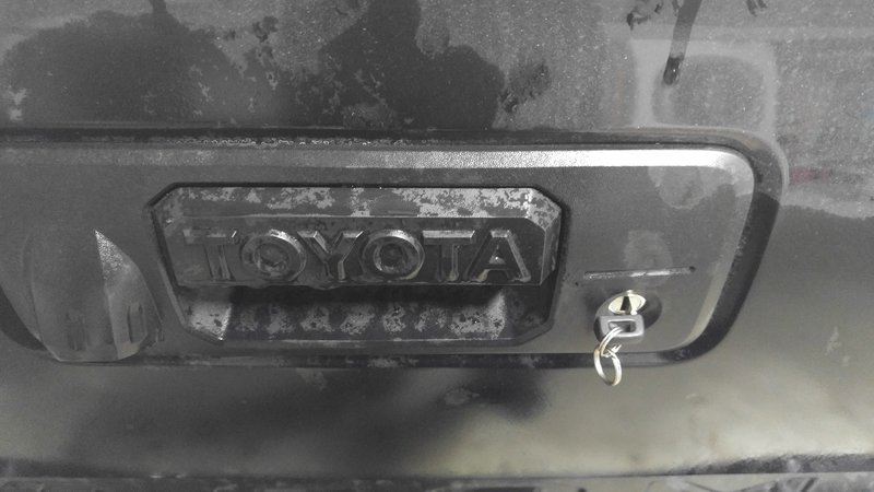

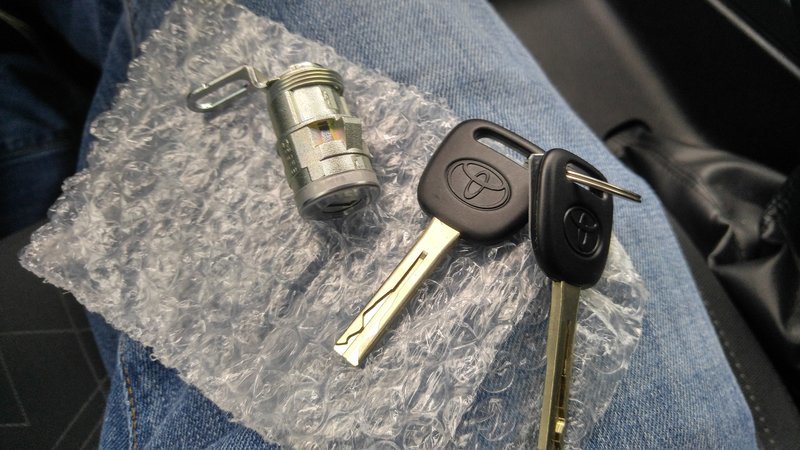

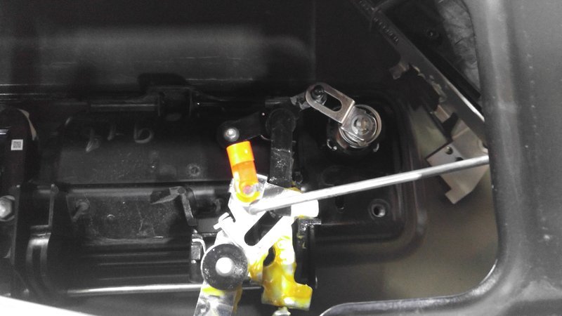

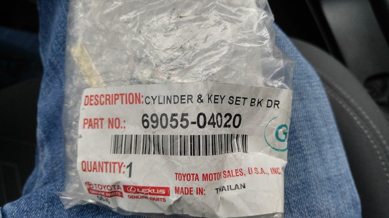

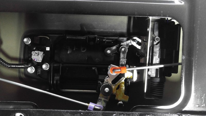

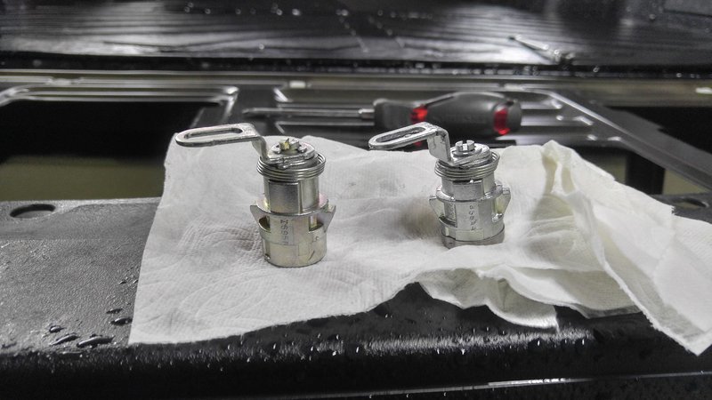

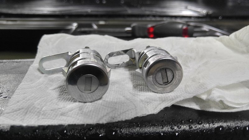

    This is for my fellow 2016 Tacoma. This is a tailgate lock upgrade to the 2017 Tailgate lock. I would recommend this mod for the trd sport, off-road, and limited, as we have to different sets of keys. One key for the drivers door and glove box and the other key is for the tailgate. With this mod you can use your key fob key to unlock the tailgate and not have to carry 2 different keys. The part number for the part is 69055-04020 and the list price is 176.92 before tax. To re-key the lock cylinder it cost 65 at my local locksmith. You will not be able to use the keys that came with it because it is already keyed for the lock. The process is the same as installing the pop n lock but with one exception is that before you install the pop n lock you will see the key cylinder and there is a silver spring looking like lock that locks the cylinder in place. Reference picture 6. In order for the lock to come out you need to pry the spring one side and pull the lock cylinder upwards. Once you pull it upwards, the lock should just come right out. Once the lock is out, you can push the new one in place and install the pop n lock. Picture 4 and 5 are reference of the locks. The one on the right is the original and the one on the left is the new lock. Once everything is installed no more carrying two keys and now you can key your key fob only.

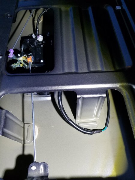

    I finally installed my Amazon actuator, but it took me 3 hours... After drilling into the metal to mount the actuator, I painted the holes so had to wait for it to dry. I wanted to run the wires through the existing clips that hold the camera cable, but I couldn't get it to fit, so I ended up drilling new holes (as other posts suggested) but b/c I had already soldered on spade connectors, I had to cut them off, so I decided to go ahead and put in a connector (to allow removal of the tailgate) except I only had more spade connectors. So all of that bloated my install time by an hour.
    Next weekend I need to do the following improvements:
    - Replace t-taps with solder
    - Use silicone to seal the grommet I cut under the passenger seat
    - Replace spade disconnect with a waterproof connector
    - Replace some split loom (I ran out of 3/8" and had to use 1/2" which is a bit too big).
    - Replace cheap 1/8" bolts/nuts holding actuator with metric bolts and nylock nuts
    As someone noted, the actuator is not that loud on it's own, I think it's getting amplified by the sheet metal. i saw one person try to put rubber washers on the outside of the sheet metal, but I think adding it on the inside (so it's separating the actuator plastic from the sheet metal) might be more effective so I'll give that a try.
