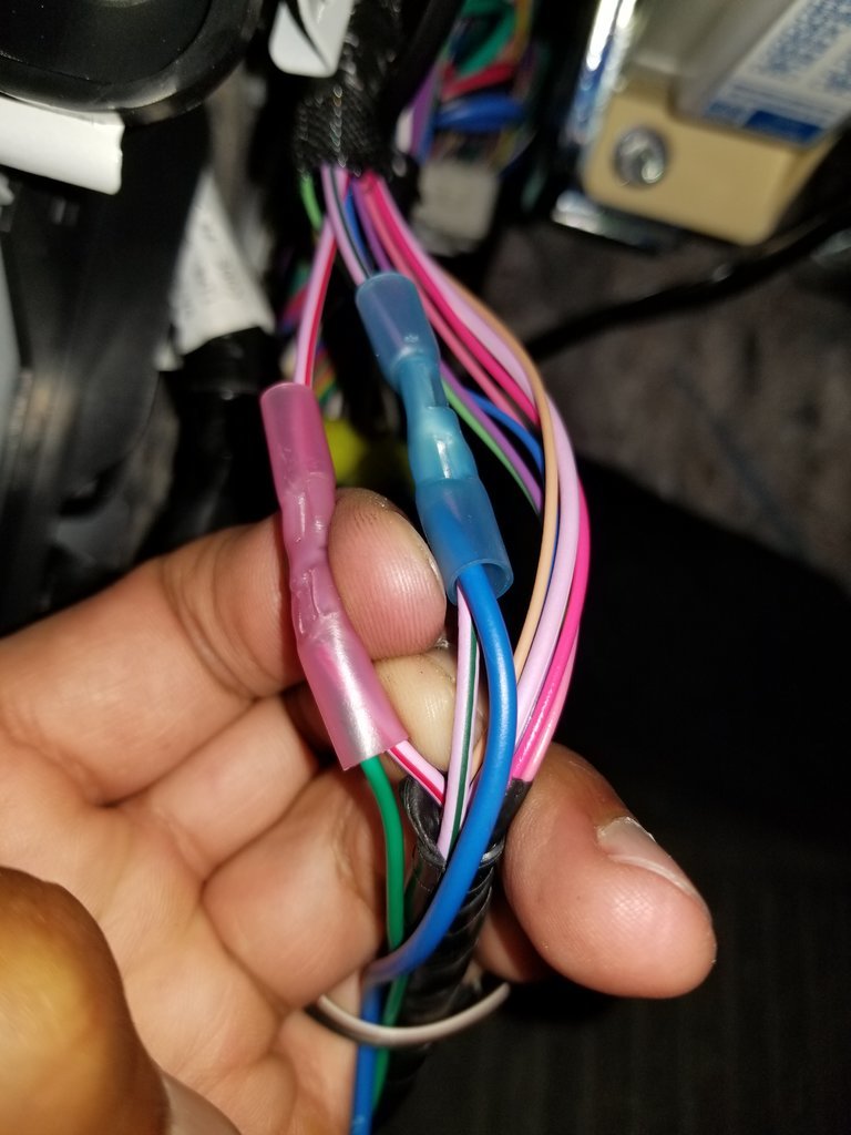

    I am having a difficult time with which color wires to connect on passenger side. any diagrams for a 2014 4dr tacoma? A 2012 has blue/black and blue pink connected to the pnl. I have those 2 wires, but another says green and red. I can't find anything pictures of this harness assembly on mine.

    I used the top right connector on my 2017. Not sure if it's the same for your 2014
    See pic below posted from another member

    My plug was black not white. Finally figured it out and finished. The PNL green went to blue/pink and the PNL blue went to blue/black. Whew!! Glad that's done. We came up the passenger grommet under the seat. Figuring out the wiring took the longest. Used the posi-tabs. Those are sweet!

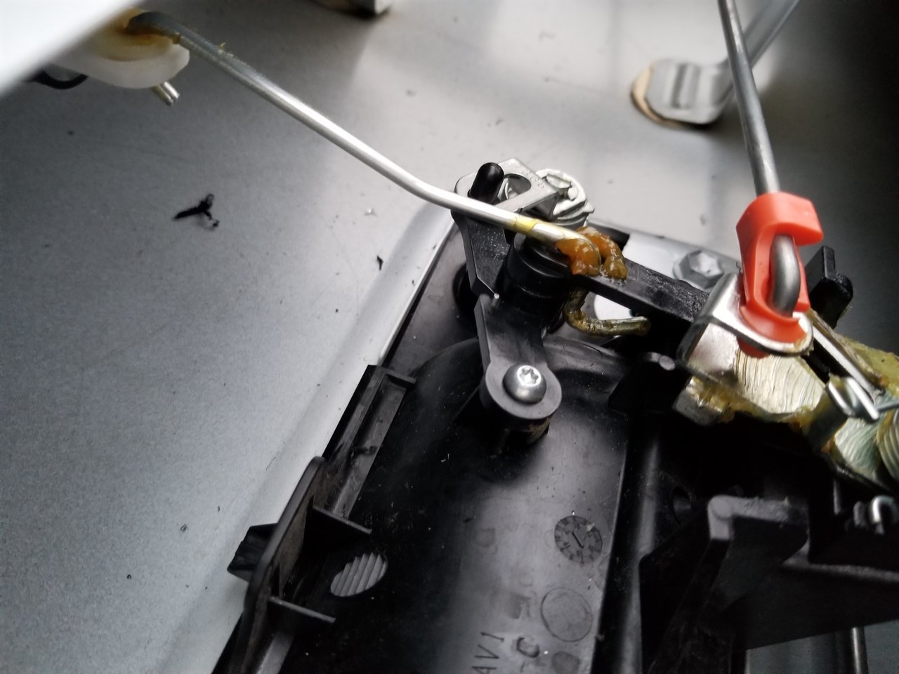

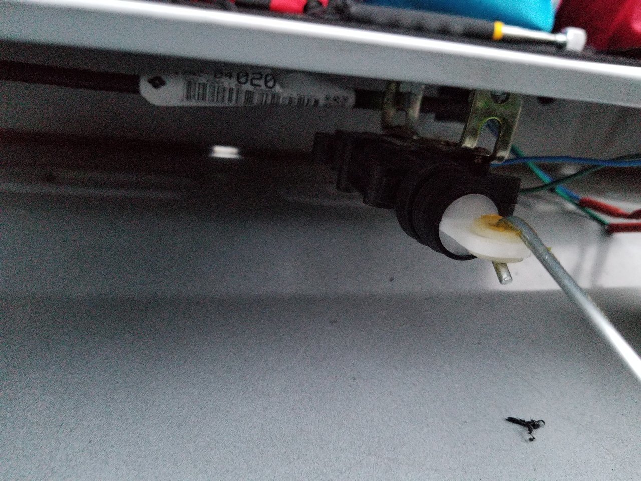

    Luckily I still had an actuator, wires and butt connectors leftover from when I used to do car and stereo alarms at Best Buy. Installed yesterday and used rentdrops wiring schematic to tap into pink/red and pink/green. As for the actuator I used some tips from a tundra forum to fold that bracket in that manner. All in all it didn't cost me anything since I already had the parts. Here are some pics of my setup to help others. Gonna put some leftover dynomat over the metal above the actuator tonight. I used to have my power doors set to unlock all doors when grabbing the handle but just switched over to just the driver's door so I can limit the amount of times that I use that actuator.

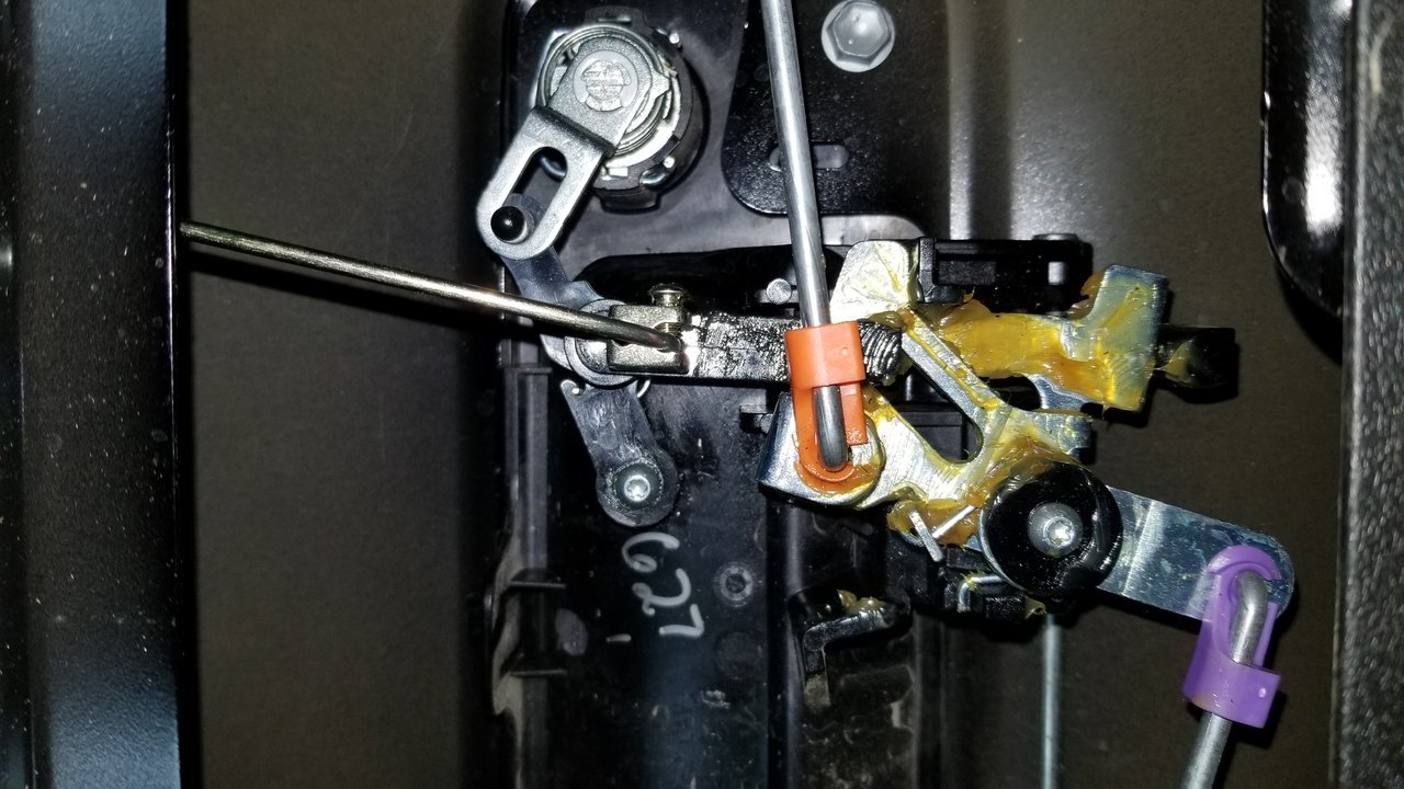

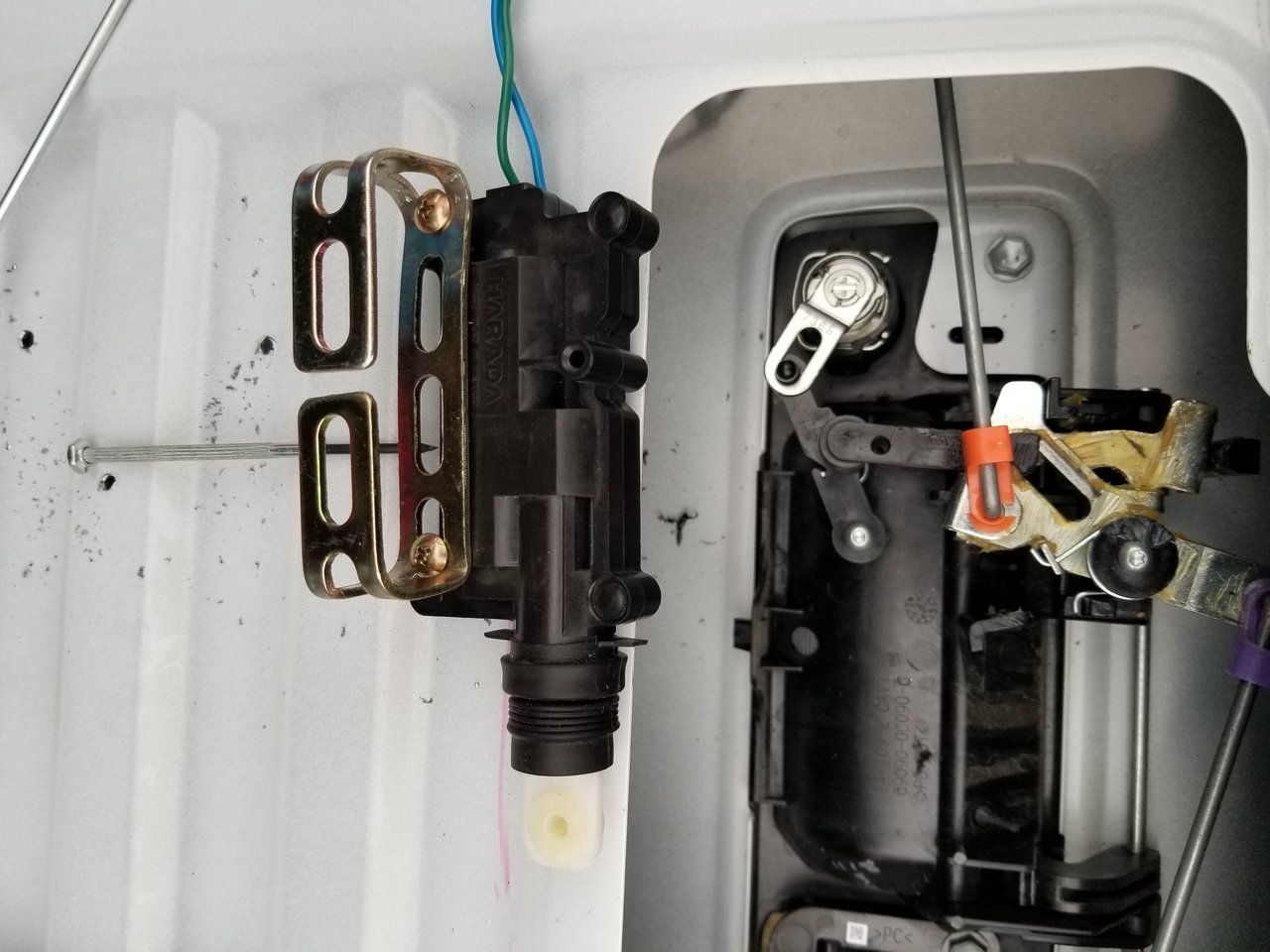

    I finished mine today and so glad I did it. I did notice, at least for my install, that when ever I shut the tail gate it would fail and I figured out that gravity was pulling the rod out just enough for it to stop working - probably due to the way I bent the rod.
    I decided to add a little block onto the rod coming from actuator to keep it from moving, so just in case anyone else runs into this too.
