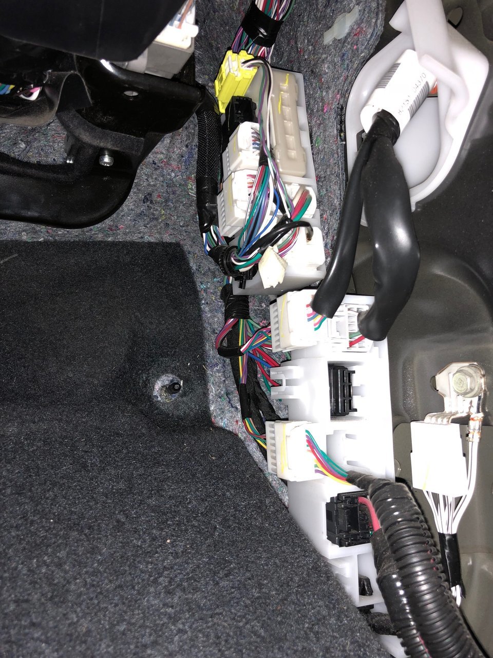

    did you wire yours through the pasanger side kick panel? im about to do mine with the pl8535 and i just want to be 100% on the wiring before i splice!

    guys... i dont mean to be that guy but i want to be 100% about what wire to place the pop n lock pl8535 into before i possible screw something up! i have a 16 TRD OR 4x2 DCSB and want to wire into the passenger kick panel... do i wire pop nlock green into green? and blue into red? can someone send me a pick of how they did theirs on a DCSB 16 trd package please please please

    Yes, that's what I did. Worse case is if it's backwards, you can just flip the bullet connectors that are in the tailgate

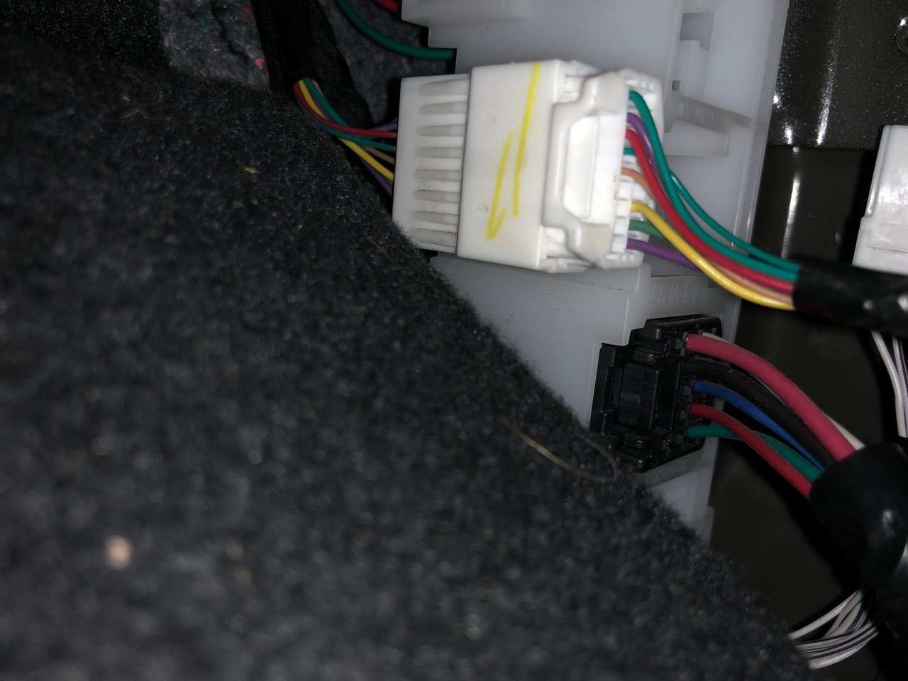

    oh man lol heres what a tech at pop n lock came up with

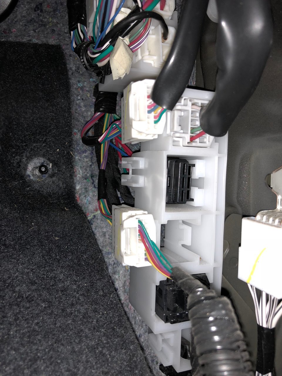

    heres the lay out under my passenger side kick panel.

    Are you guys using diodes to stop someone from activating the passenger door locks by simply putting 12VDC on the wires you guys ran outside the cab?

    It's the black plug in your first picture. Green to green, Blue to red. This will make it work with the passenger door.

    I did the passenger side kick panel. The pix I took are of the passenger side.
    @dilbert had it right. Black plug, the lowest connector. Green to green, red to blue. Easy as pie!
    @Double Phister no diode, why bother? Thieves aren't going to probe wire bundles with 12v, they are wrapped and there are a few of them anyway. Easier just to use a dent puller on the lock and take the tailgate that way.

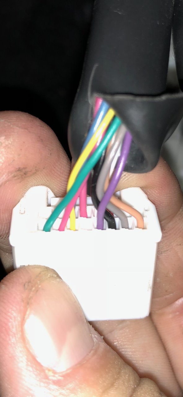

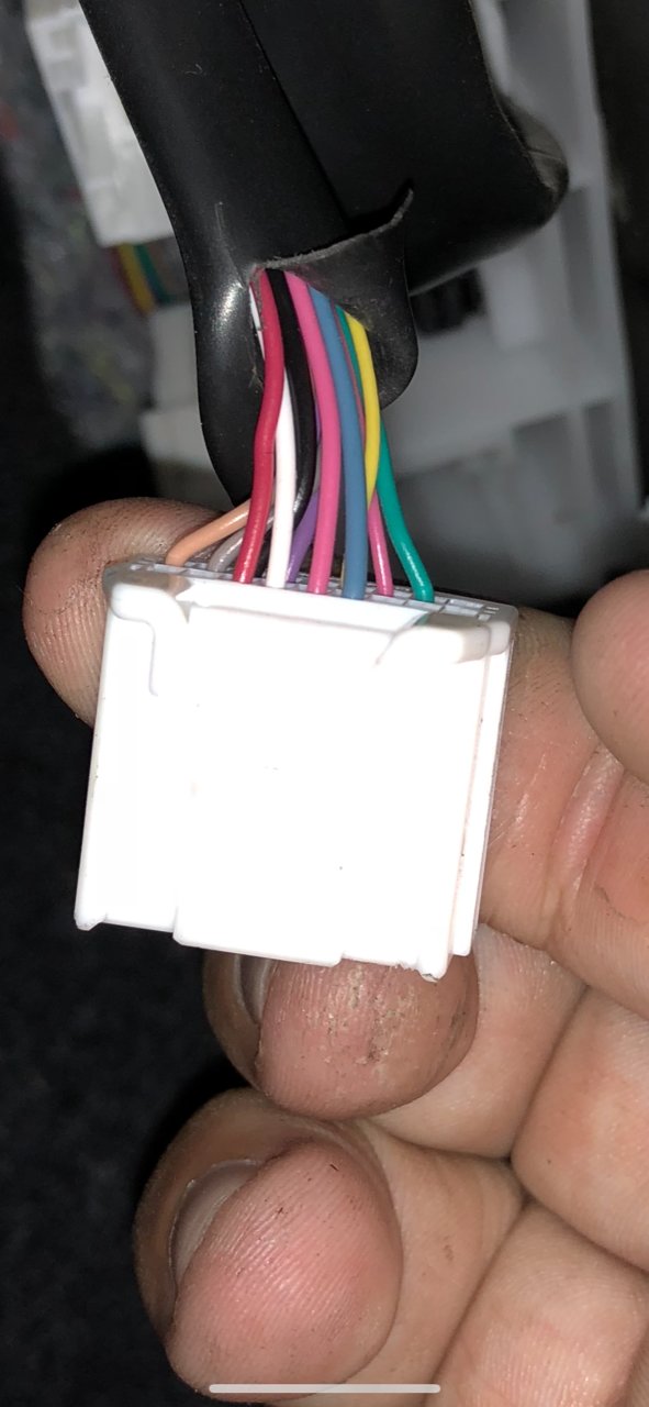

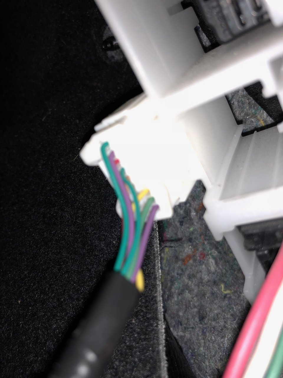

    Can someone explain the difference between tapping into the passenger side white plug or black plug?
    Seems both work based on replies here and video online.

    I cannot explain the difference, but I used the driver side and it worked flawlessly.
