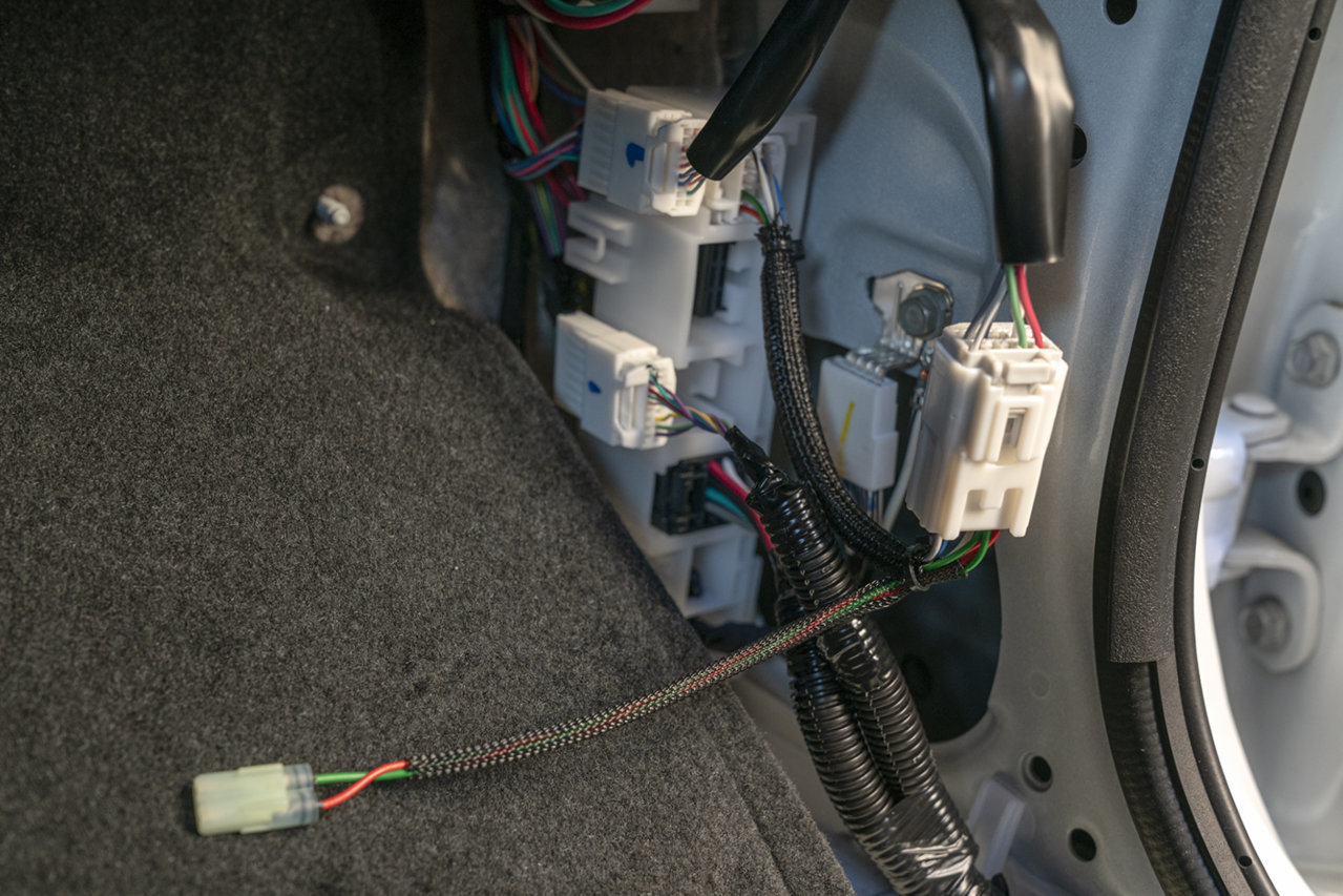

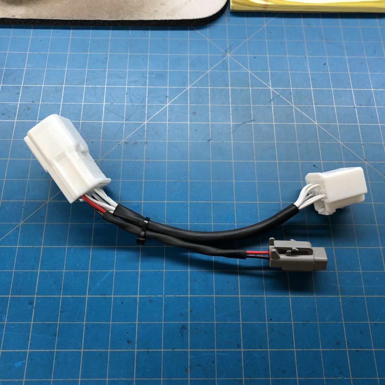

    Thanks to your post decided to have one made too with a little tweaking. Had a couple buddies who work and own a motorsports wiring business help me make the harness adapter, also had them change out the bullet style connectors with something much better too. Works perfectly.

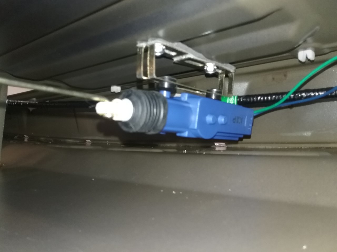

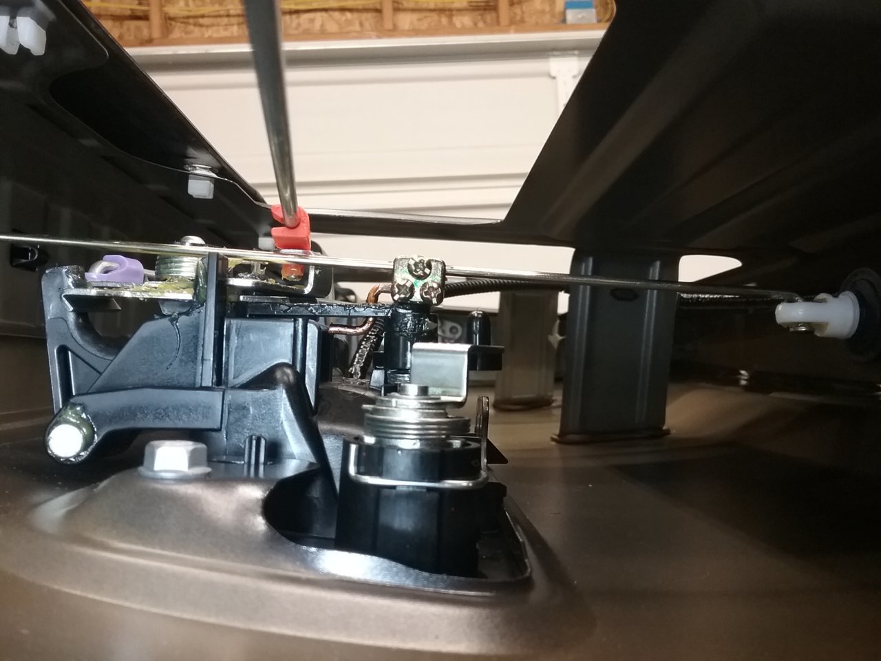

    After reading all 31 pages I decided to take all of the good ideas and installed an actuator as well. I noticed a common frustration and designed mine to make it easier to mount. On Amazon I found an actuator that had an adapter that attaches to an existing rod. So I cut a small piece of 12 gauge solid wire and bent it to fit the lock arm hole. Then I attached the adapter to it and the actuator rod into the adapter. This way all I needed to do was tighten the set screw at the proper distance with no bending.
    I also borrowed the idea of bending the mounting bracket into a rectangle to use as a spacer. Further, I used rubber washers and window stripping to keep the actuator sound from transferring to the tailgate. 20181020_213929.jpg
    Another note about the sound, I tested it using a 9v battery and it worked perfectly and quietly. But when I used 12v the action became a lot more violent and louder. I read another member thought about installing a resistor. Does anyone know of an in line 12v to 9v resistor?

    Thanks benkitesurfs and Aznray. I made one of these myself :muscleflexing: Would have been easier if I had a crimping tool. Always get extra pins and sockets so you can screw a few up like me. I used a Delphi MP150U as the connector to the Pop and Lock wire.

    This should do it
    KNACRO DC-DC 12V to 9V 2A Step-down power supply module Car power converter module Synchronous buck With Reverse connection protection https://www.amazon.com/dp/B06VT5DVG1/ref=cm_sw_r_cp_tai_UCMjCbNB53PK3

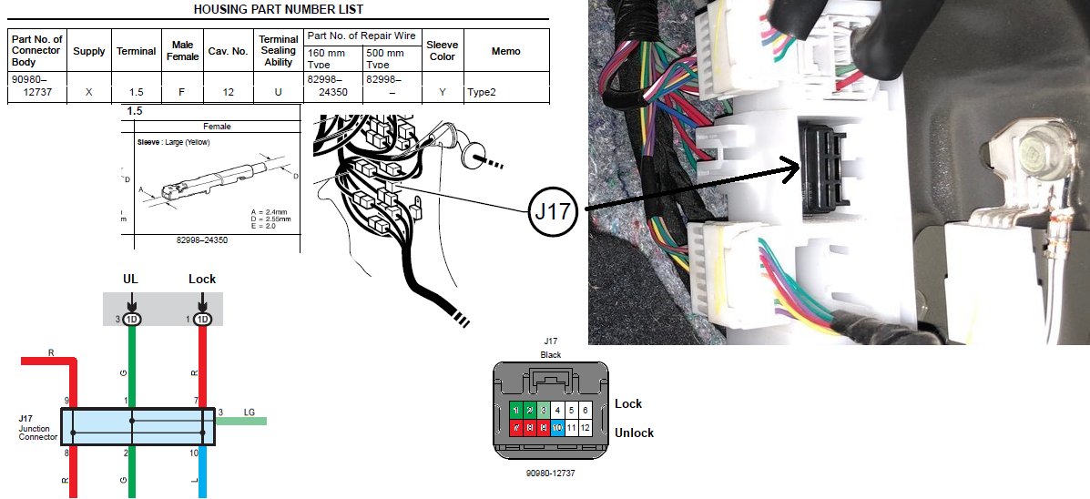

    No OEM connectors needed, just the terminal wires soldered to the added harness from the locking solenoid, remove J17, remove cap, open locking bar insert into correct opened slots. Very inexpensive.
