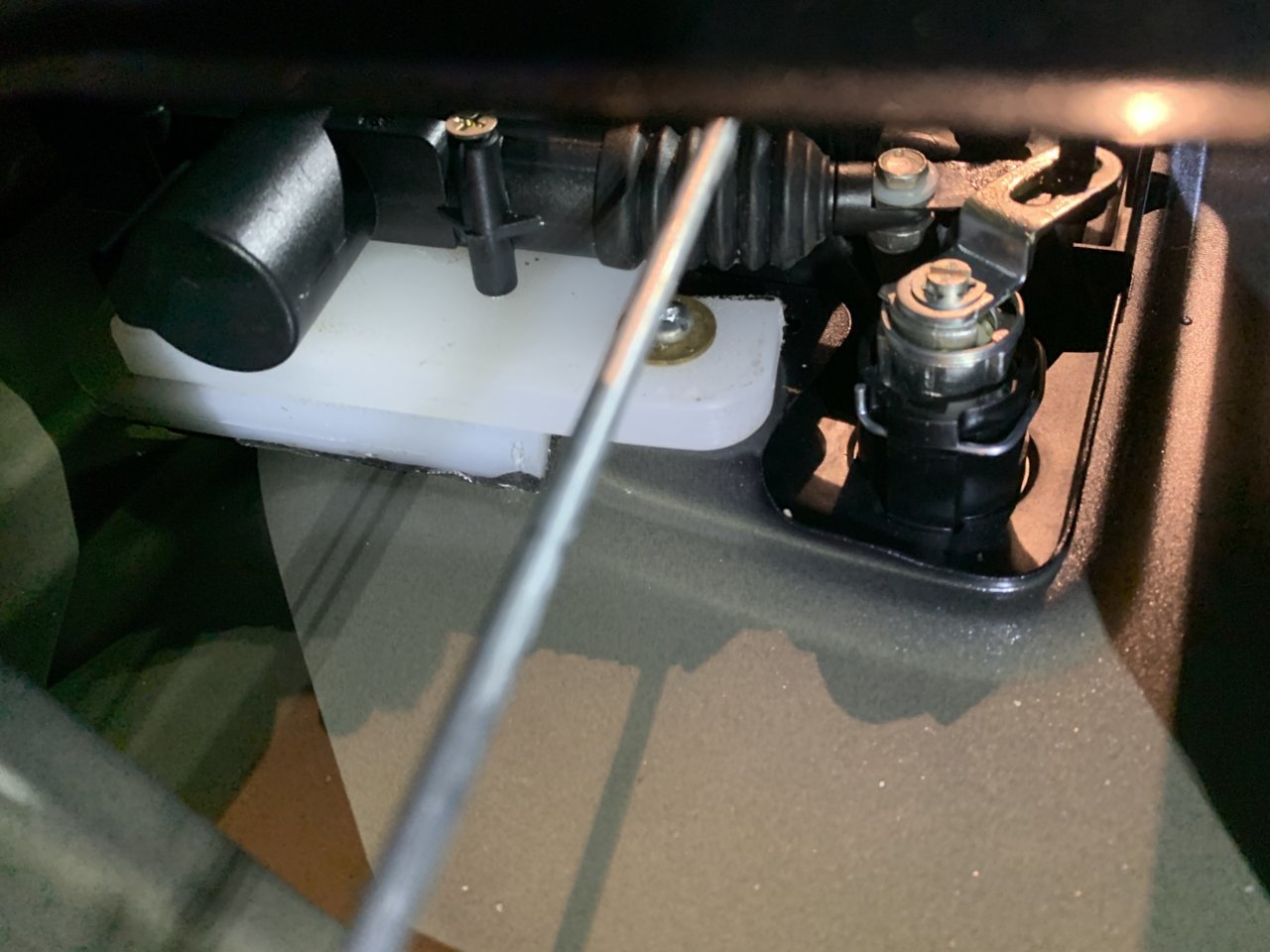

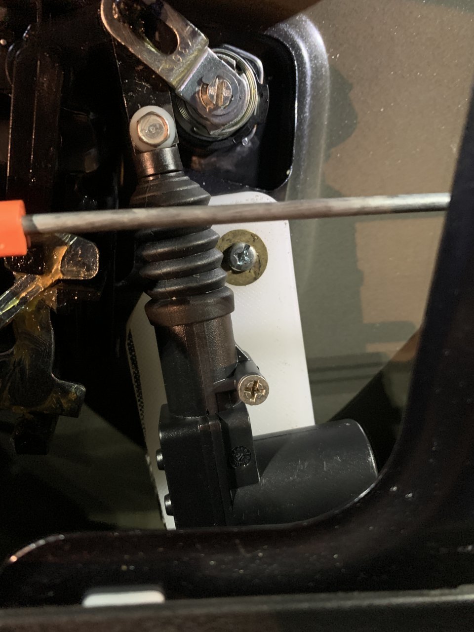

    Made my own bracket using cutting board deadens the sound a ton. Solid as a rock too,
  10. Sep 4, 2021 at 6:37 PM
    #650
    teamhystyk
    teamhystyk Member
    Jun 11, 2021
    #368301
    10
    Dan
    2021 Tacoma TRD Sport
    side view
