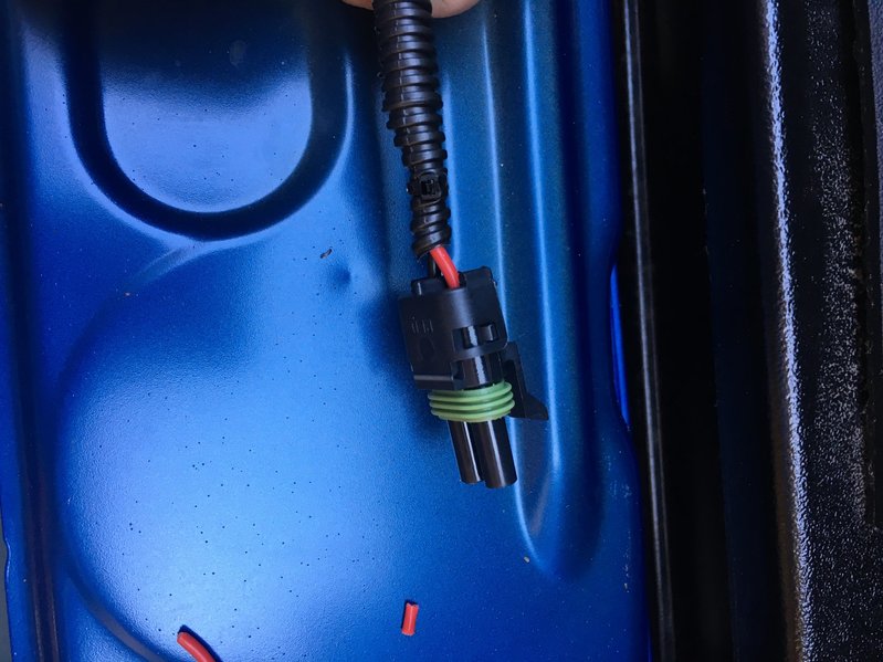

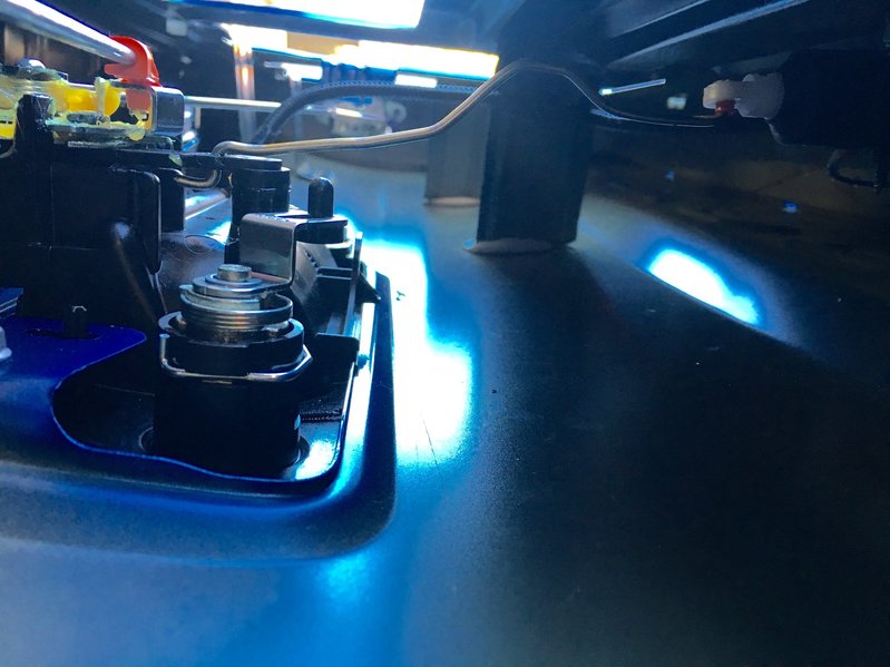

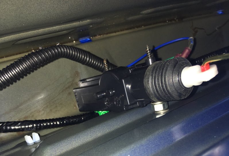

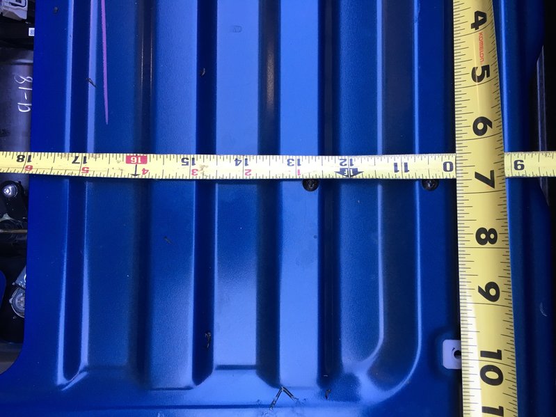

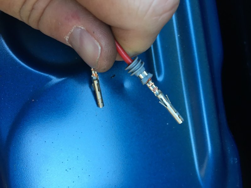

    I managed to get mine in today, after having the parts for about 2 weeks. I pretty much did it the same way as the OP, except for a few small differences. I took some pics that should add to the OP.
    This should give an idea of where to mount the actuator. If you follow the small tape to the left, it points at the latch. The wide tape 10" mark is centered on the white screw insert.
    Since the mounting area isn't flat, I used washers on either side of a nut to act as a spacer.
    This shows the rod going from the actuator to the latch. The bend in the middle allows you to adjust the length of the rod by tweaking it.

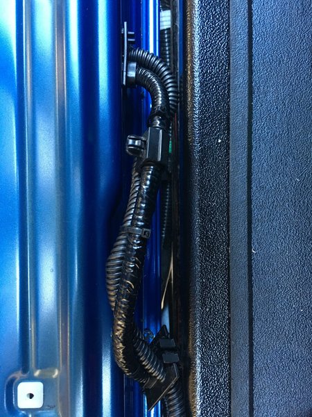

    I drilled holes in the factory plastic inserts and tied the loom to the same harness as the camera.
    Properly crimped weatherpack pin for the plug under the bed.
    The plug I used for the actuator wires under the bed.

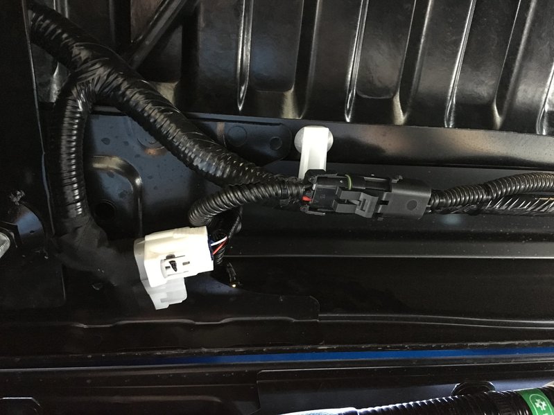

    Under the bed - the white connector on the left is the one for the camera, the black one to the right of that is the 2-pin weatherpack connector I used to unplug the actuator if I ever decide to take the tailgate off.
    The harness from the plug, all the way up to the front kick panel was 20ft long. I cut that much wire as a guess and it ended up being exactly the right length.
    Overall, it took about 3 hours working at a casual pace. It was pretty easy, but I've done actuators before, so I'm sure that helped. Hopefully this info will make it a little easier for someone else.

    I'm also going to look into putting a resistor inline on the actuator wire, because this thing is a lot stronger than it needs to be for the job and makes a pretty noticeable "thunk" inside the tailgate.

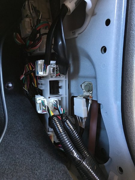

    Which wires do I use in the front??
    I have everything done and cannot figure out which one it is.

    When you remove the kick panel - look for a small harness that runs vertically near the door opening. They are attached to a plastic clip that holds them to the body metal. There are two wires that are larger gauge than the others. Pink with a red stripe - and pink with a green stripe.

    It looks like you're on the passenger side. I tied into the drivers side. Still, follow the wires coming out of the boot from the door - they should be in there.

    I also went to the passenger side. I didn't see any striped wires at all on the harness from the passenger side door, so I poked around with a multimeter probe and so far I'm 50/50--my tailgate locks when I hit either button, attached to light blue and green.
