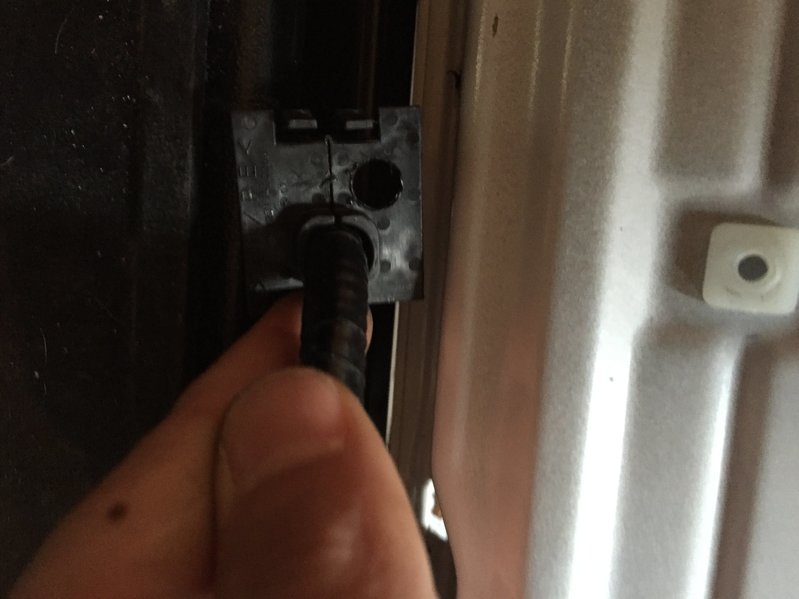

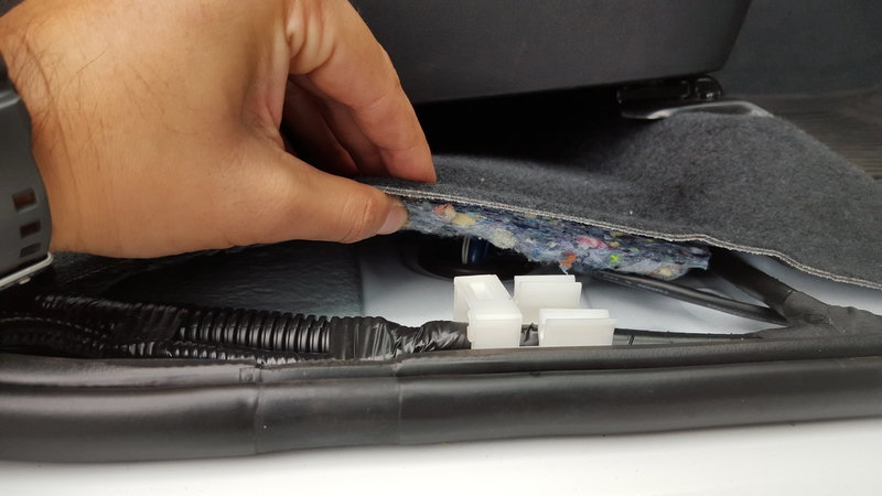

    Maybe I missed it, but where is the best place to bring the wires into the cab?
    I was planning to route them along the frame to the front passenger corner as well....but haven't poked around yet.
    Is there any other wires coming through a grommet in that area that makes easy entry?
  4. Dec 6, 2015 at 6:46 PM
    #124
    giantBOB
    giantBOB Active Member
    Oct 25, 2015
    #167644
    27
    2016 DCLB Sport - Whiter than white.
    image.jpgCut the nipple and run it through.

    Cool, thanks. Just pulled the panels off the passenger side to check it out. Looks like you gotta poke through a little insulation too....Gonna order up the pop lock version tonight.

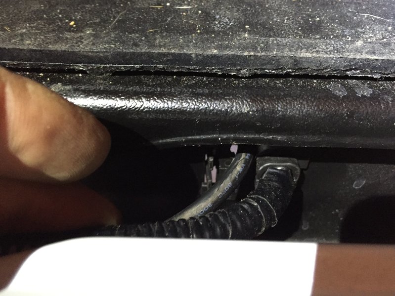

    You do and it is bit tedious. The wiring on the pop and lock is all plug and play. The directions don't give the right wires to tap into but if you look at my previous post it shows in the photo. image.jpg Here is a tip...drill out the holders for the backup camera and feed the harness through them. There are no drain holes and it is a really clean application. image.jpg

    Good deal, thanks! I noticed there was no holes in the tail gate and was contemplating drilling through the metal. Much better / cleaner idea....thank you.

    I also drilled a hole through little plastic piece for the camera cables. Ran wires along passenger frame following other cables as a reference.
    Below the passenger door is where I accessed the cab and kick panel. I spliced green to green and blue to red referencing the previous pics but those ended up being back words. Simple fix at the actuator part just switching the wires.

    68
    2016 TRD sport 4x2
    I noticed a little grommet under the passenger door. I cut a little slit and ran cables through easily. Electric tape job after.
