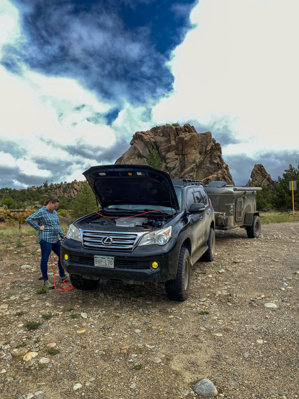

    Having had both the 15lb PowerTank and the ARB single, here’s my thoughts:
    The PowerTank is fast for sure, but the storage, refilling (which was $40 per time here and sometimes they kept it overnight which was a major inconvenience) and fear of it running out when more air is needed was a major reason for getting away from it. I used it with our trailer setup, so six 33” tires to air up on trips, and it’d only last me 3-4 air up cycles, which I could easily exceed on a long weekend.
    The ARB single was notably slower to fill, but acceptable for my use, it was nice having “unlimited” airing up abilities and it tucked away under the hood without robbing storage space and was easier to deploy.
    I’m going to fit an air up kit to my new Tacoma and it’ll be the ARB dual compressor. Same pros as the single, but faster.
    Unless you need the pros of the tank (air tools, setting a bead, etc) the compressor is a clear better choice IMO.
    My pregnant wife saying the single ARB was too slow and we need the dual:
    My experience with fill up times, from 12-18 PSI to 36 PSI on 33” tires, attachment on to attachment off, was as follows:
    Powertank: ~30-40 seconds per tire
    ARB Single: 90-120 seconds per tire
    Expected ARB Dual: 60-90 seconds per tire
    All would probably be 5-10 seconds faster if I had a gauge that read constant pressure instead of having to stop and check PSI a few times towards the end.
