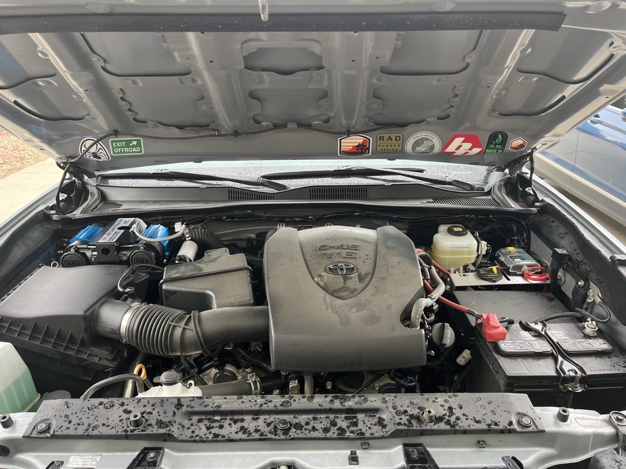

    Had an ARB twin tank compressor under the hood of a 2019 with a front locker and was very nice.
    I now have a powertank for my 2022 (just picked it up) and I feel it's sufficient.
    The tank airs up nineteen, 33" tires and is portable. I do t need multiple air ups any more. A tank full will last me a year, easily.
    I'd say it depends on your usage, budget.
    They are both great options

    Just to confirm, I moved back to a Tacoma from the GX and did indeed go the dual ARB route.
    I’ve had the power tank and I’ve had the ARB single…and I happily spent the ridiculous coin to get a dual ARB setup on my new truck, if that tells you anything.
