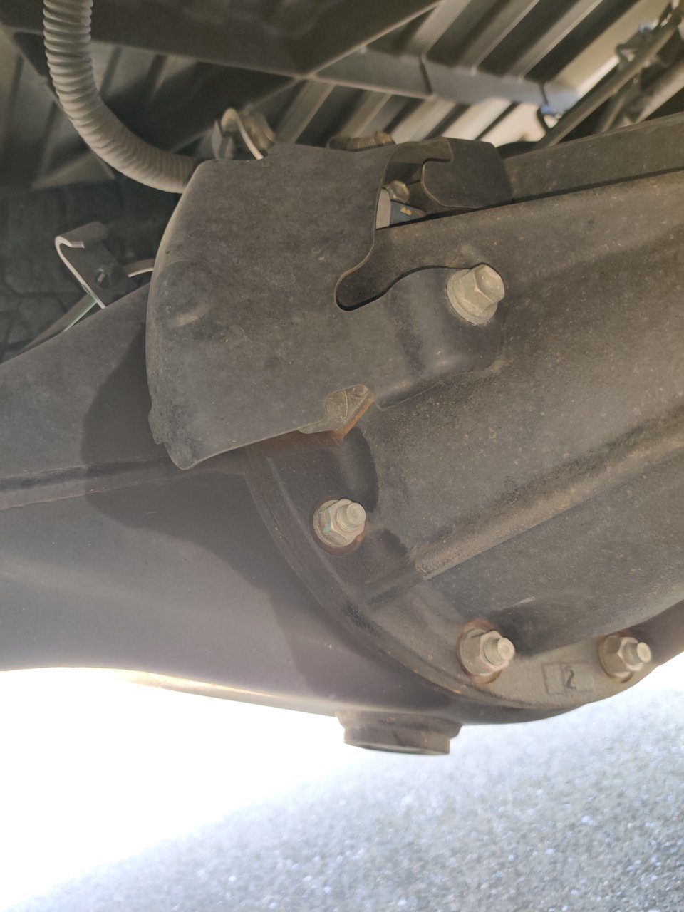

    just shy of 30k, doing most of the maint myself. The rear diff is weeping/leaking (no drips in the driveway though). I called the dealership and was told my '17 OR warranty is up, and the gasket wouldn't be covered. I assume a gasket wouldn't be covered in the 60k warranty because the gasket itself is not an internal part, but am I wrong?
    Anywho, afaik the OR models were not included in the rear diff recall. How bad does this look?

    I'd call that a weep and would not worry about it unless it gets much worse. Toyota dropped a TSB that classifies leaks and weeps / seeps. Given that, I don't think they would have done anything even if you were still under the bumper to bumper warranty.

    Cool, thanks. I'll try and mark it or clean it off so I can keep an eye on the size. They quoted me ~$442 for both diffs, xf case, and diag fee to check the diff/gasket. I've had zero issues with the truck. Bought it was ~15k miles. No diff whine, or any of the other issues commonly posted here. I think if anything I'll just do the diag and still pan to do the fluids myself.

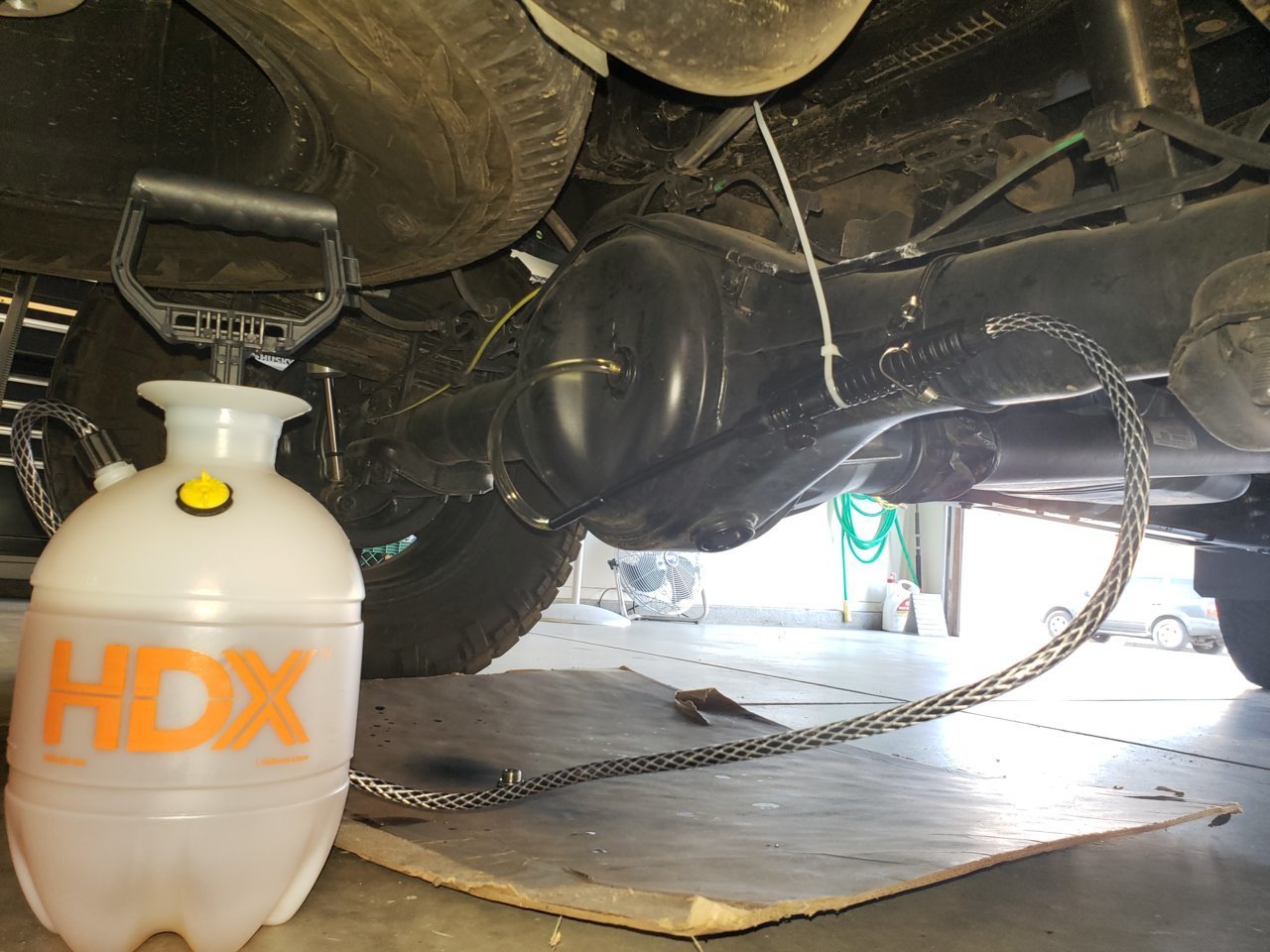

    $442 for swapping fluids? That is robbery. I did the diffs, MT, and T case for about $240 including the crush washers.
    Here's a good guide:
    https://www.tacomaworld.com/threads...-manual-transmission-6mt-fluid-change.481719/
    I am going to make a modified weed sprayer for the next time:

    I think for the rear I'll just drop the spare and fill it from the bottle. Thanks for the link, hadn't seen that post yet.

    Dropping the spare is a good option. Another is that some gear lubes can be purchased in pouches.
    I did it by refilling quart bottles and hand pumping it. It wasn't too bad but took forever. Just squeeze it in.

    I used Ravenol, but I saw the oil analyses for it afterward. The Toyota stuff has a much bigger additive package. Since I did the 2Lo Mod and am using it pretty much daily, I will get the Toyota stuff next time unless more analyses get posted. There is a thread around here somewhere that lists all the fluids that are noted to be compatible.
    On level ground, 1L was enough for me. It started dribbling out the fill hole just as the bolt was empty.

    One thing you could CAREFULLY check is the torque spec on the diff cover bolts. I believe there was incorrect torque spec from the factory. I swear mine had the slightest dampness/staining and after re-torquing and cleaning it off it hasn't come back and that was years ago. I also filled with M1 oil.

    Stuff is expensive, but not that expensive. Just buy it all from redline and do it yourself. It's so simple. Do check torque on the 3rd member bolts.
