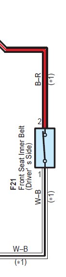

    Removing my Driver's seat I found this unused black & white plug. When the truck is on I can measure 14v though it. Really would like to use it to power a USB plug but I don't know what it is.
    Anybody identify it? Is it on a separate fuse?

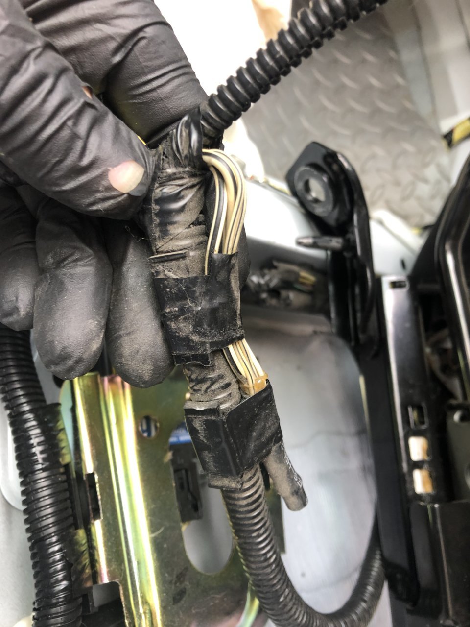

    While I got you here. What's this bundle?

    That wire bundle looks like a ground splice pack, generally White/Black wires are grounds on Toyota vehicles.
    What are the wire colors on the connector in question?

    The wires are blue w/red stripe and white w/black stripe. I confirmed the white w/black is a ground.

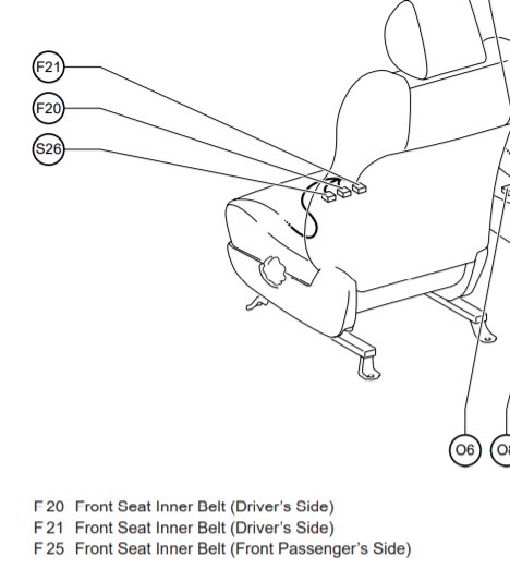

    It's for your seatbelt warning light

    That's correct! I must have forgot to hook it up last time I had the seat out. :oops:
