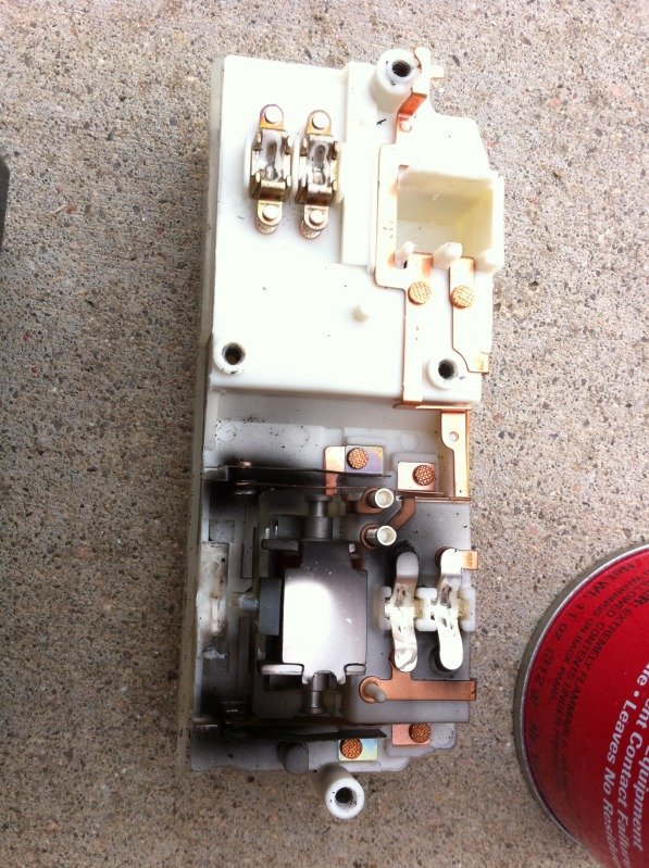

    Before (the driver's side contacts are those long blade types that are covered in residue)

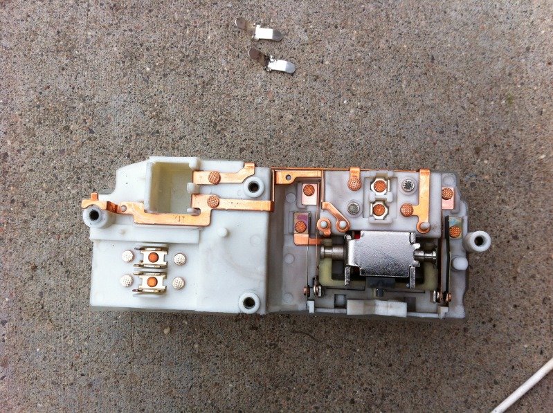

    After
