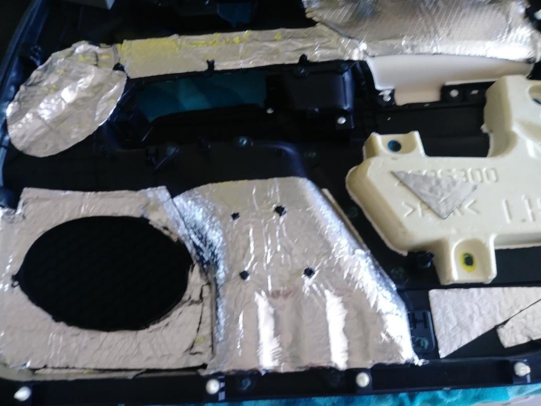

    Most likely the switch, just did not work all of a sudden. I had the part off when i did speakers a while back.
    my dealer 35 mile drive does not stock the part plus first wants to diagnose it then order, more than likely a month to get it fixed. for the price on the link i might just eat it and get it fixed. plus there is always a chance they don't approve the warranty due to some loop hole when they see the sound deadening i did in the door.

    no, i did not even add deadening pads in the door, i stuck them all over the inside of the door panel. cretin it is the switch since i use it a lot, drive with windows down and always adjusting, wear and tare on a 2016
