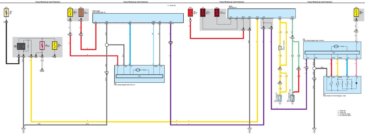

    The Taco with Jam-Protect Windows are always powered but the Main Body ECU controls (via LIN) the relay that handles the up-stop you pinched something feature.

    Jam Protect circuit Access Cab:

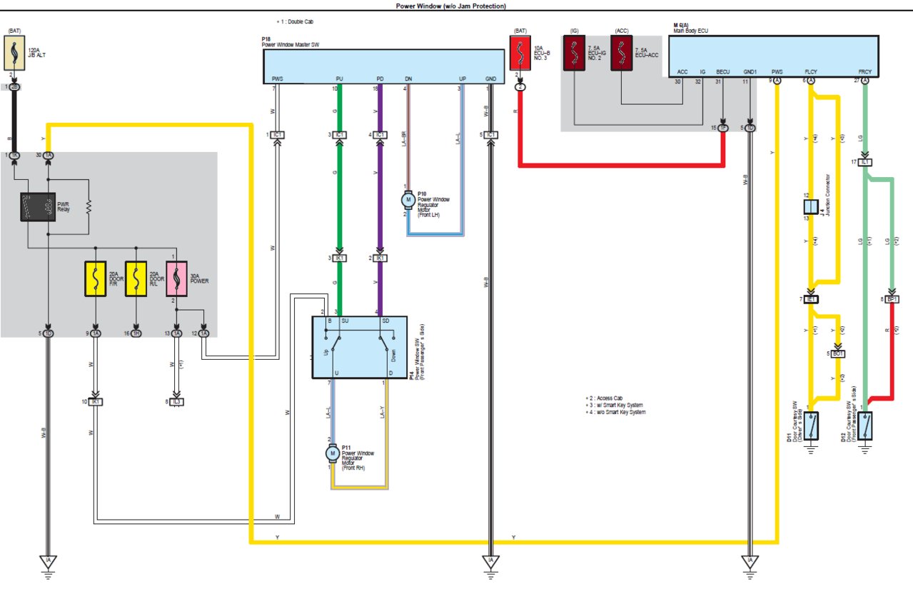

    Plain Jane Access Cab"
    In "theory" you could snip the yellow relay control on the Plain Jane circuit and tie into the cabin illumination wire. It stays ON "always" but sleeps to OFF after engine is off for 20 min. Opening a door or turning on an interior light wakes it up, then another 20 min count down to off if engine/acc stays off. Pressing a window switch would wake the circuit if tied into that circuit.

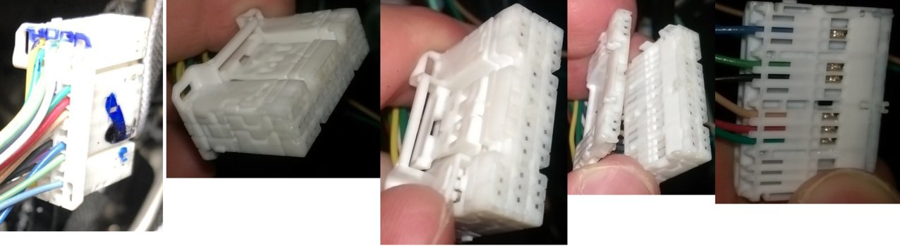

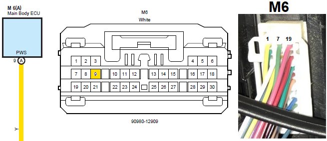

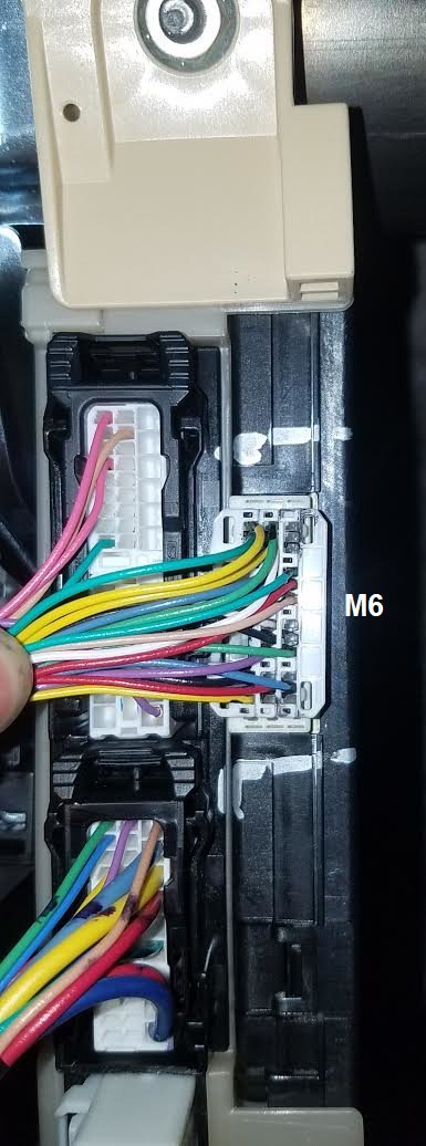

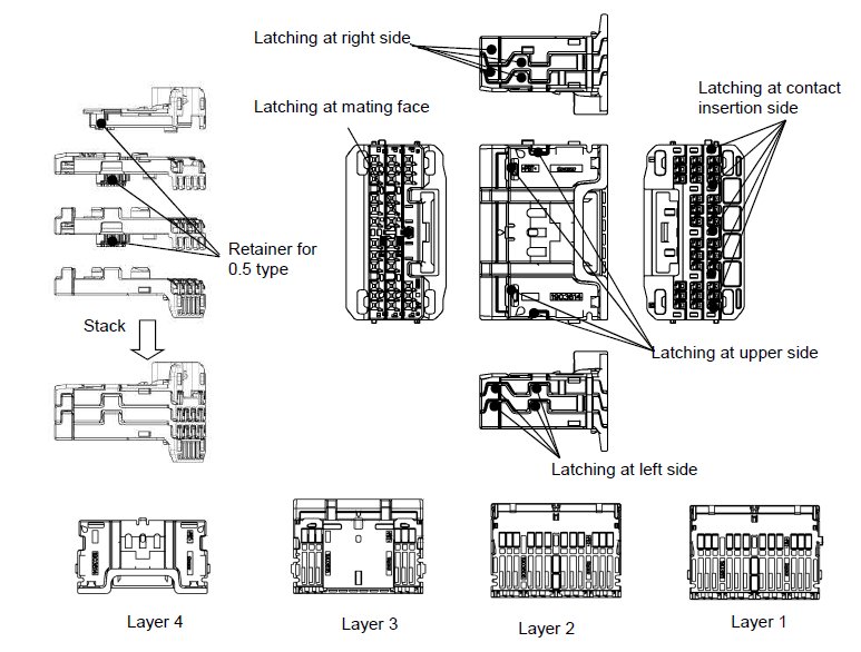

    M6 can be dissembled to extract the wire and terminal.
    Jump the removed pin to 1D_19 and test.
    Remove battery negative beforehand.
