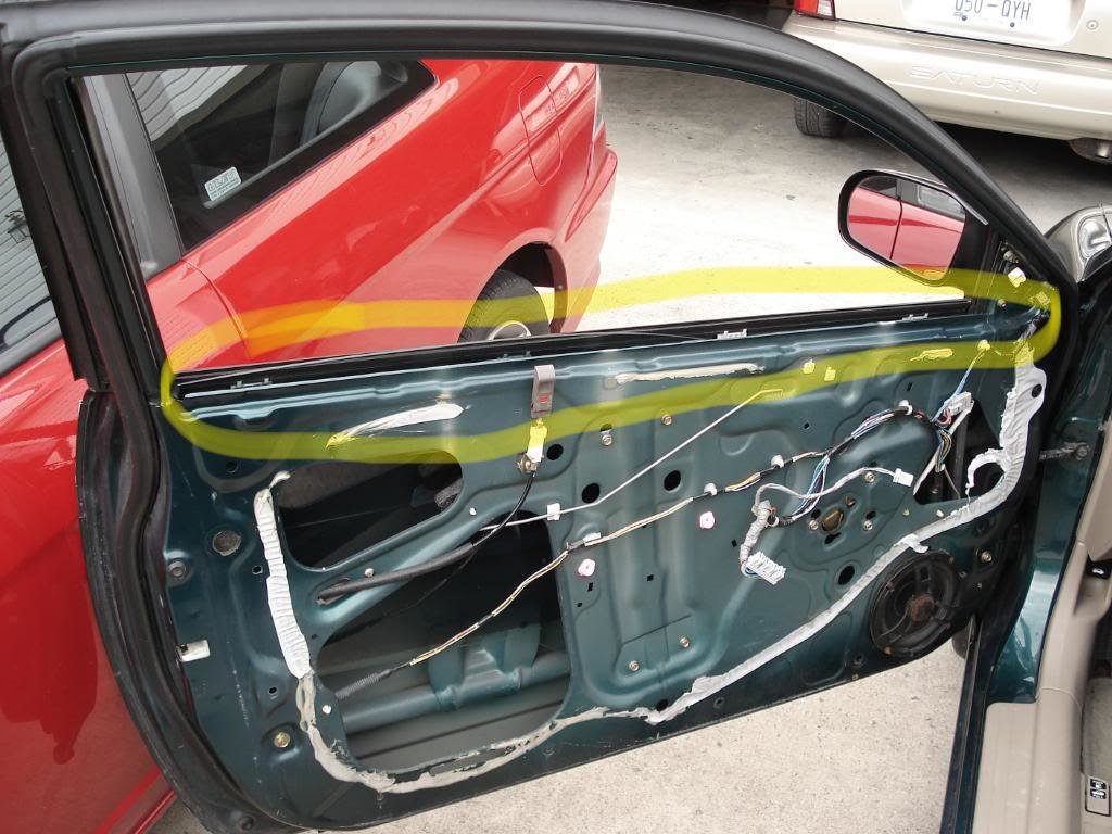

    Experienced the driver window doing this. I’ve had it on happen on a few of my other cars in the past. Found it to just be dirt/debris that’s the issue.
    Roll the window down and run your finger / rag through the door trac to clean it. where the window goes down into the door. Should do the trick.
    Sourced the pic off the line for reference.
