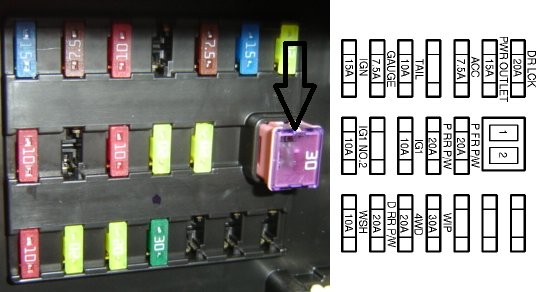

    Yep, all fuses are good. That was the first thing I checked.

    How about getting a new 30 amp fuse and swapping it out...Each window has its own fuse. Just the Driver's side window is "special". it has to handle the auto down feature...

    I had the same idea, spent $5 on a new 30amp fuse. Didn’t work.
