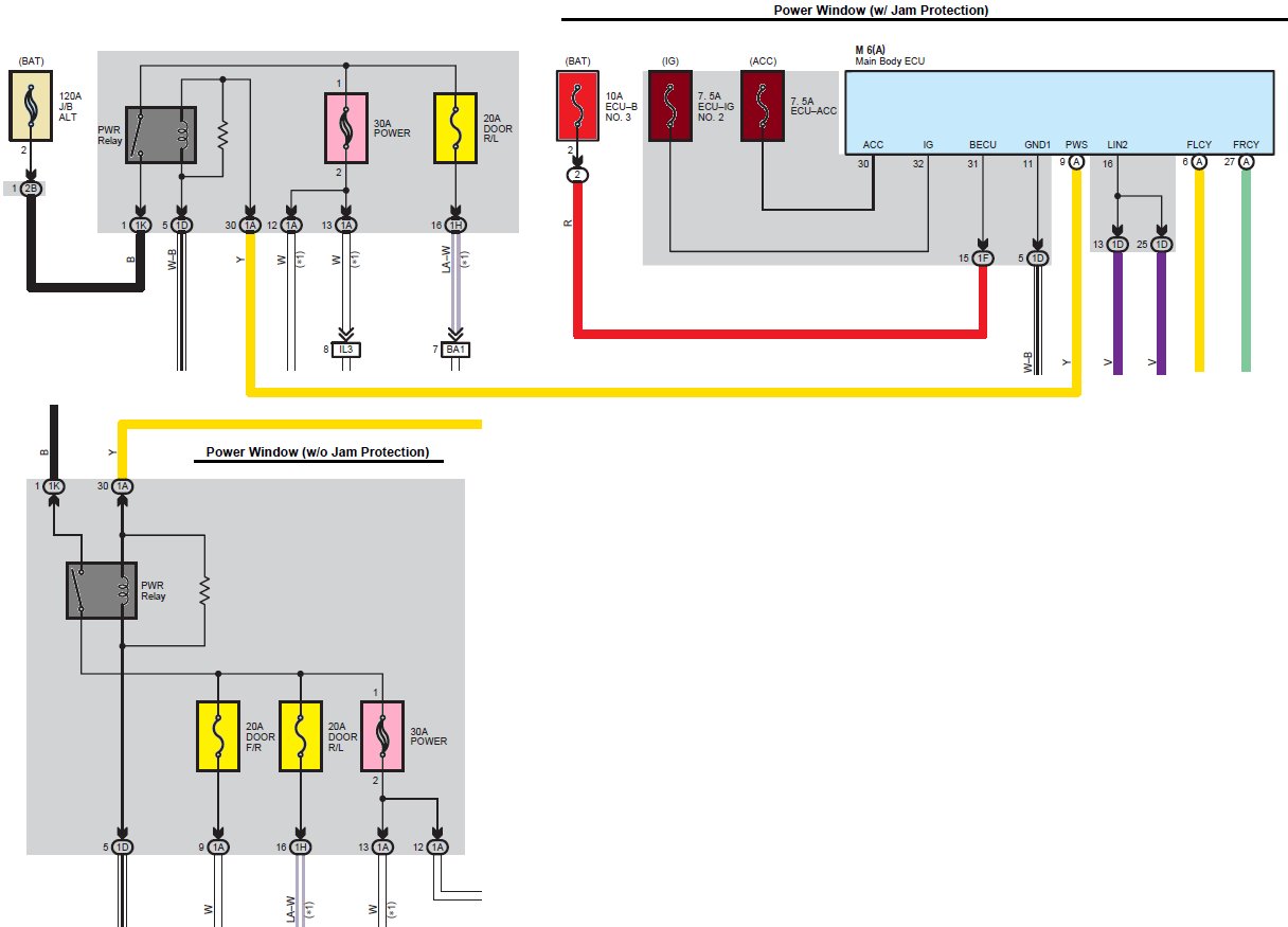

    Window schematics are on page 21.

    Thanks, I'll look later, can't open on my phone.

    I'm going to be honest, this is like Chinese to me.

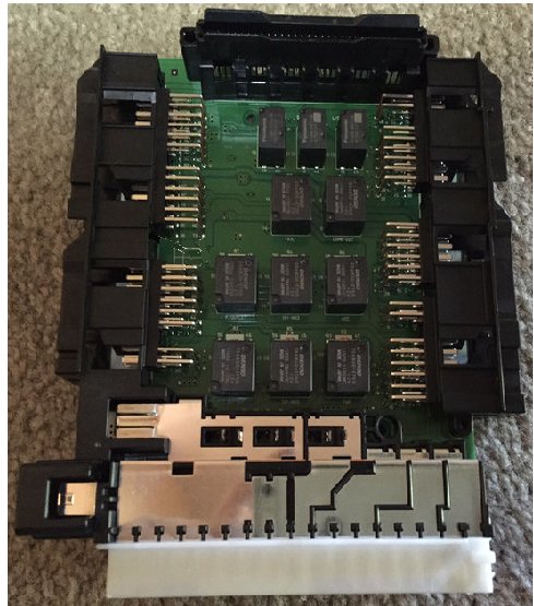

    Does anyone know what relay would be for the power windows or where its located?

    Caribbean, Puerto Rico
    05 PreRunner TRD Offroad AutoTrans
    Hood Struts, My version Fogs always ON, Map & Overhead Light Mod,
    It's soldered to the IC board..none removable....
